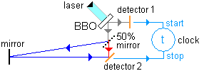

Propose this measurement:
It is a well know interference measurement, but now asymmetrical.
Suppose the red path is 1 m and the blue path 10 m. If you measure the time between detector 1 and 2 I expect you will find two times: 3.3 ns and 33 ns. Then you know which path the photon took. But between BBO source and detector 2 the photons are not disturbed, so according Feynman rules there will be interference.
Who know what is wrong here, because QM predicts different.
No. What you have built is a version of a Mach-Zehnder interferometer. Even for classical light, unless the coherence time of the light is longer than 33 ns, you will not get interference. For single photons created by PDC, coherence time is typically short - usually below 1 ps. If you use pulses instead of cw light, you need good overlap of the two pulses at your detector to get interference. See the huge amount of literature on the Hong-Ou-Mandel effect for typical timescales.

But if you calculate it with the Feynman paths, what is the result? Feynman does not take coherence time into account and also works with paths of different length.
If coherence time is less then 1 ps there will be no interference if the path difference is less more then 0.3 mm.

What do you mean by that? Photons are only indistinguishable within one coherence volume. For longer timescales/spatial scales they are distinguishable particles. Probability amplitudes just add for indistinguishable pathways leading to the same result.
edit: Just to make it a bit more clear on the technical side: Assuming a cw light beam, phase coherence gets lost on a timescale corresponding to coherence time. Calculating the path integral over two terms with random relative phase, you will not get an interference pattern.

With the BBO I used the setup of Kim e.a. It is a crystal which, when radiated by laser, now and then emits two photons at the same time each with half intensity of the laser photons. So I am talking about single photons
You intended to write half the energy, I assume. That is correct. For single photons from BBOs coherence time is short and only few "paths" contribute and it is hard to create a good double slit experiment. This is why you do not really see a true single photon double slit experiment very often. You usually see setups which use a low mean photon number and have a small probability of having more than one photon in the setup at any repetition of the experiment. For this kind of experiment you can just use an attenuated laser which has huge coherence time. In that case a lot of paths contribute.

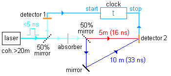

Your OP spec was about a 30 ns difference. That is pretty large, no interference to consider in any picture. So no conflict.
Now suppose it is small as you are now saying. There would be interference effects to consider in any picture. So no conflict.
And as previously mentioned, entangled photons generally lack the coherence needed for double slit interference. I am not sure if a MZI setup has that specific problem or not. Still no conflict between the views as you had imagined in your OP.

So in my measurement 1 ps after emission in the BBO a single photon is on its own with a wave cone as you mention above?
I would not phrase it that way. It sounds as if there was some well defined emission time which is not the case. You know that there is some time window with the length of 1 ps during which the photon could have been emitted. The emission will lie on a narrow cone as given by phase matching. If you measure the direction of emission of the second photon you can in principle get some information about which direction on the cone is realized in a single run of the experiment, but one does not have to do that.
Generally speaking, what you will get is a nonzero detection probability for your photon inside a volume which is given by the cone in x- and y-direction and the uncertainty of the emission time times the speed of light in z-direction.

But it is my intention to look to single photons, because it is often explained that with single photons you will get the same interference pattern (after adding a lot of single measurements)
Let me make it simpler. Suppose I have a point source with a "superposition" time of 1 ps. Then after 10 ps, how does the wave of the photon look like. Spherical I suppose?

I try to argue that the start measurement does show an interference pattern. Cthugha disagrees because of a time argument I have never seen elsewhere. Step by step I am trying to close the gap between his opinion and mine. I am not yet sure how it will end: one of us is right or we misunderstand each other. Because my knowledge is minor to his, my official goal is to work from his opinion to mine, to understand what he means.
