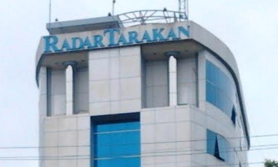

After much googling and snooping, I tracked down the purported photographer(Agoes Suwondo [ref 1] ), his occupation(photographer & vice manager [twitter & facebook] ), employer(CV. AN Studio ADVERTISING [facebook again] ), where the photo was taken from(sixth floor of the Radar Tarakan building, an Indonesian newspaper), and ended up with the following message on my browser;
Om's browser when he clicked on the wiki link for the homepage for "Radar Tarakan" said:
Your connection is not private
Attackers might be trying to steal your information from w3.radar[unsquirrel.at.your.own.risk]tarakan.com (for example, passwords, messages, or credit cards). NET::ERR_CERT_AUTHORITY_INVALID
:oldsurprised:
Anyways, the building is a curved, and the windows on the sixth floor, though individually flat, may have been smooshed, just enough to oblatisize the secondary image of the sun.

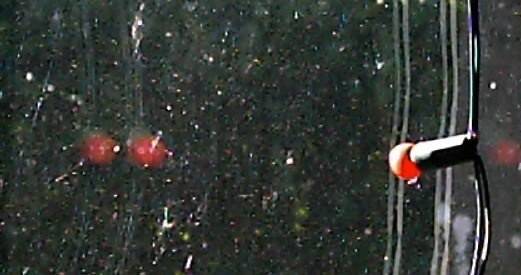

Since I only have one double pane window in my house, and the sun was fortuitously shining in the correct direction, I took a picture.
Now, this doesn't really prove how the original picture was taken, nor created, only that double pane windows can create double images.
As for how filthy my windows are, I can only claim as an excuse, that clean windows kill ≈ a billion birds a year, here in America.
