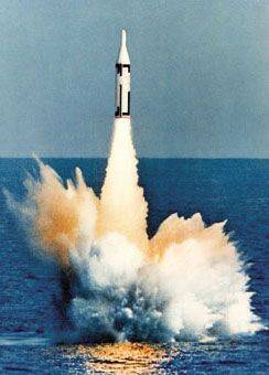

http://www.royalnavy.mod.uk/upload/img_400/tomahawk.jpg
I would say the "splashing" you see is after the missile leaves the water and the water falls into itself to fill the void left behind. I.e, that shouldn't change your drag - I wouldn't suspect it to.
In the case of small / short objects, the time it spends at the liquid-gas interface is, indeed, small.
However, I am also interested in the case of “big” objects, such as a really long cylinder (or missile, as in the case of your picture) where the time it spends at the interface is considerably longer, ignoring any rocket thrusters of course.
I can, as you suggest, simplify the problem by making a high-low estimate of what the drag force will be using the assumption that the object is still fully in, or out of, the water as it passes the interface.
As a physicists who rarely complicates things by taking into account drag, when I saw a discontinuity in my medium I thought, “hey, this might be an issue those engineers have to deal with sometimes”, but it would seem that it is me who is adding unnecessary complications.
