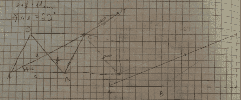

I'd really need help with this. Thanks.

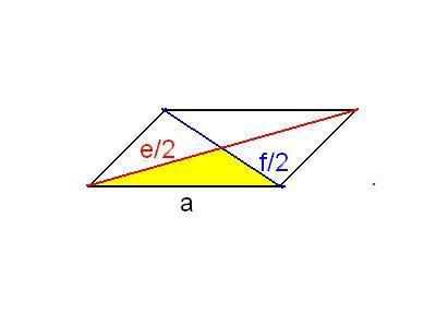

1. Homework Statement
Draw a parallelogram:
a = 4cm
e + f (diagonals) = 11cm
angle between a and e = 22°
2 and 2 sides are parallel
both diagonals halve each other
(diagonal e goes from A to C)
(attachment)

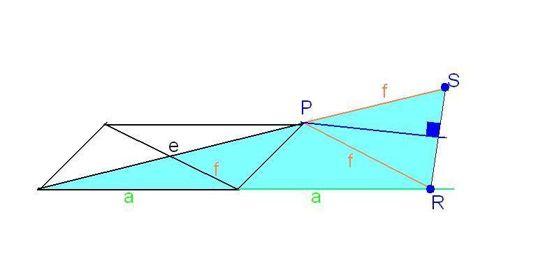

Go ahead with your attempt! You have drawn the blue triangle. PRS is isosceles. Halve the side RS and draw a perpendicular at the halfpoint. It defines point P.
ehild

Thanks, got it. You're a life saver. By the way: Why wouldn't this work if a = 8cm? Is it because a would be longer than the sum of e and b (if we take half of it as a triangle)? Or is there another explanation?
a can not be longer than (e+f)/2. The yellow triangle would not exist.
Thank you! (I menth something like that, yes)
