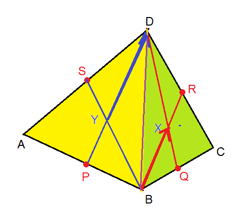

By definition, BR and DQ are medians in the green triangle BCD, X is the center of gravity and it divides the medians in the ratio 1/2. It is the same for Y in triangle ABD. The thick blue and red vectors are of the same size and have the same angle with the BD, the common side of the two triangles. Find congruent triangles.

so congruent triangles are:
BXD and BYD
DPB and DRB
QDB and SBD
SPY and RQX
ASP and QCR
so that must mean that
ABD and BCD are also congruent

What about the angles? Are DR and PB parallel?

It is not enough, you have to point out which sides in ABD and in BCD correspond to each other, and these sides are parallel.
DR an PB must be parallel since PD and BR are parallel and have the same length
BS and QD are also parallel
AD also has the same length as BC
and AB has the same length as CD
So AB=CD and AD=BC
Therefore AB must be parallel to CD and AD must be parallel to BC

It is all right! But you should have said why the triangles are congruent (for example, BXD and BYD have two sides DY and BX equal, one side (BD) common, and the same angle between them. And it would have been enough to show that DR || PB involving DC || AB and SD || BQ, involving AD || BC.
