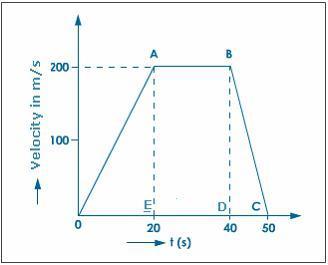

hey there, I'm a little confuse on how to draw a s-t graph from a v-t graph :( based on the graph attached, the displacement of C is lesser than D, but why the s-t graph is not like in a 'bell' shape ( curve down from D to C) ? instead it went up? if the question were to ask for a distance-time graph, will it be in the same shape?
  • Velocity-time graph: velocity in m/s against t (s). Velocity rises linearly from 0 at t=0 to 200 at point A (t=20), stays at 200 to point B (t=40), then falls to 0 at point C (t=50). Dashed lines mark points D and E on the time axis.

The velocity is always positive in that graph so of course the displacement will allways increase.
