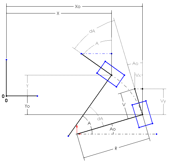

The next drawing shows the trajectory followed by the vehicle (in blue) within time dt, from position 1 to position 2 (click on the image to enlarge):
You can see the origin 0,0 which is the reference point for X,Y data. There is also the radius R and the velocity V, which is perpendicular to R. The radius (R) is related to the velocity (V) and the lateral acceleration (aL) by definition.
The angular displacement dA can be found with the angular velocity of the vehicle (w) with respect to the instantaneous center of rotation where w = dA/dt but also w = V/R.
The velocities of the vehicle are by definition Vx = (X-X0)/dt and Vy = (Y-Y0)/dt.
All of this leads to the previous equations.
As you can see in the drawing, the radius R changes from one position to another, but the instantaneous center of rotation too. So the longer is dt, the greater is the error.
