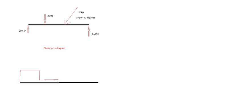

I was wondering how you incorporate an angled load into a shear force diagram? So far I've only been working with vertical loads and I've looked through my entire book without finding an example with loads at an angle, so I'm not sure what to do here. I know I have to end up at 0 so I see I can't just continue on 25 downwards...
Figure with measurements attached.
  • Hand-drawn beam diagram with a 25kN vertical downward load, a 25kN load at 60 degrees to the beam, reactions of 29.6kN and 17.1kN at the ends, and a rough shear force diagram below.

You would need to split the force at an angle into vertical and horizontal components. Only the vertical will produce a shear force.
