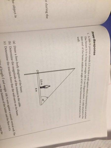

Janet1234
A 500-N person stands 2.5 m from a wall against which a horizontal beam is attached. The beam is 6 m long and weighs 200N (see diagram below). A cable attached to the free end of the beam makes an angle of 45 degrees to the horizontal and is attached to the wall.
Textbook diagram of a horizontal beam attached to a vertical wall at point O, with a person standing 2.5 m from the wall, the beam 6 m long, and a cable from the free end to the wall at a 45 degree angle.
Free-body diagram of a horizontal beam against a wall, with a 500 N downward force at a point, a 200 N downward force at the far end, a tension T at 45 degrees, a reaction force R at angle theta, and components T sin 45 and T cos 45.
I'm not sure what is the force R mean in the answer, and why is it pointing in an angle theta instead of perpendicular to the wall.
I drew a normal force at the end of the beam perpendicular to the wall, which is apparently not the right answer haha.

Hi Janet, welcome to Physics Forums!
The beam is attached to the wall by a pivot, and the pivot can act with force at an angle.

Its not hard to see why that force must have a vertical component - if it didn't the beam would fall down.
