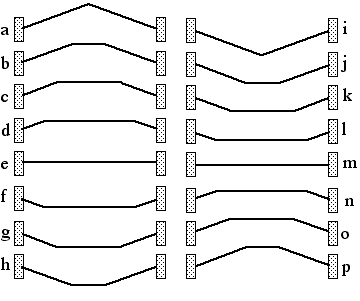

Consider two identical springs A and B with 100 loops, the loops are numbered in both springs so that the loop 1 in each spring is the closest to the ground and the loop 100 is the furthest from the ground. We start two identical experiments. They start falling identically as expected. At the time the loop number 45 will start moving we use a very clever mechanism to cut, with minimum disturbance, the spring A so that it becomes two falling pieces: the subsystem 100-46 and the subsystem 45-1.
Do you believe loop 1 of spring A will move at the same time of loop 1 in spring B?
In my opinion, the loop 1 of spring A will move first.
1) a subsystem whose mass and size increases in time.
2) another disjoint and complementary subsystem containing elastic tensions which are decreasing in size and naturally in tensions.
3) this last subsystem retains an equilibrium configuration which was set up at the beginning of the experiment.
As I believe in the importance of the role of the subsystem I described in the item 1 above, let me ask you a question:

Physics is not about opinion and yours is wrong. It indicates you simply do not understand the physics in play.DaTario said:In my opinion, the loop 1 of spring A will move first.
As long as the motion is one-dimensional, the upper system will keep crashing into the lower one. Cutting the spring will not change this. The force in the slinky is one of compression, not of tension.
If you somehow managed to make the two pieces not collide, it will take longer for the lower coil of A to move because the lower part is not receiving any monentum from being crashed into by the upper part.

Not really. In the idealised shock wave description, the tension drop is a step function. Cutting at the time of the step function arriving is a sufficient level of description.A.T. said:The level of idealization and the time point of cutting the spring need to be defined more precisely here. If the tension between loop 45 and 46 has already dropped to zero, then cutting the loop does nothing.
To be more specific, if you can satisfy this:
Then it is still easy to compute the times. The relation between the shock wave travel fraction ##\sigma## and time taken is given in my Insight:Orodruin said:If you somehow managed to make the two pieces not collide, it will take longer for the lower coil of A to move because the lower part is not receiving any momentum from being crashed into by the upper part.
\frac{gt^2}{2L} = \sigma^2(1-2\sigma/3)
Here, ##L## is the slinky extension under gravity ##g##. In particular, the full (##\sigma = 1##) drop time is
t_0 = \sqrt{\frac{2L}{3g}}.
If we cut when the shock wave reaches ##\sigma = 1/2## for cleaner math, the time until the cut is given by
\frac{gt_1^2}{2L} = \frac{1}{6}
ie
t_1 = \sqrt{\frac{L}{3g}}.
The time after the cut is given by the original formula relpacing ##L\to L/4## and so
t_2 = \sqrt{\frac{L}{6g}}.
We are thus comparing ##\sqrt 2## to ##1 + \sqrt{1/2}##. It is elementary math to conclude the second - corresponding to the cut slinky - is larger.
