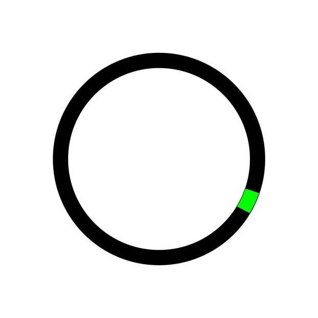

So if we filmed the slinky from below from the moment it was released with its lower metal end painted green as in the picture below, we would see this end rotate as it descends, is that it?
fig.: Slinky seen from below.
Not very much. It is a twist wave signal. This signal will also take some time to reach the bottom, but it will be faster than the longitudinal shock wave. As the twist signal reaches the bottom, it will reflect off the end of the spring. This will result in some twisting motion and typically also excite some longitudinal signal from the bottom up. If you look closely you will see the reflected twist signal as well as the lower end actually falling a little bit as the twist signal reaches it.
  • #124
Yes, I saw a subtle longitudinal wave rising from the lower end.
It seems to behave as Wilberforce pendulum with almost zero moment of inertia.
