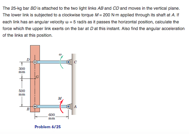

Dynamics: Forces in mechanism problem
The discussion revolves around a dynamics problem involving forces in a mechanical system, specifically focusing on the forces acting at point D of a bar supported by a rod. Participants are examining the components of forces and the implications of torque in this context.

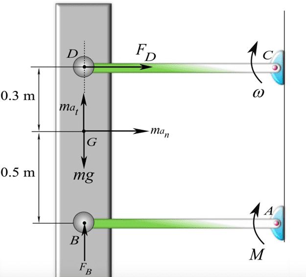

Viewing a solution on the internet to this question, the free body diagram is drawn as:
The forces here are then used to solve for ##F_D## and this is given as the answer to "the force which the bar exerts on the link at D". I'm just confused as to why there is no vertical component of the force at D, ie ##F_Dy##. Then the total force at D is $$F_D = F_{Dx}\hat {\mathbf i} + F_{Dy}\hat {\mathbf j}$$
Cheers

Think of the situation carefully... The whole mass of the bar is sustained by the rod ##AB## when the rod passes the horizontal position, and the torque at ##B## pushes it up at this instant; so there is no effect of the weight ##mg## upon the rod ##CD## in this position, right? Where from then, the end ##D## would experience ##F_{D_y}##?

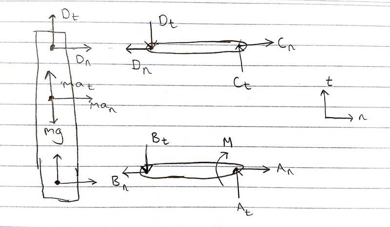

My FBD looked something like this:
DDshwSqAnDYEwyvCBq5HDd1wkU6g1ffMkkBntor9IjRPc7jz1ZHq-G9ncdp4U1UJzR0RgddmuvrPNmflH8=w1627-h949-no.jpg
  • DDshwSqAnDYEwyvCBq5HDd1wkU6g1ffMkkBntor9IjRPc7jz1ZHq-G9ncdp4U1UJzR0RgddmuvrPNmflH8=w1627-h949-no.jpg

No, it won't be equally distributed. At this instant, the torque ##M## on the shaft ##AB## solely does the job of lifting the bar. The upper shaft is made to move with the bar by the torque ##M##, not that the shaft ##CD## moves the bar. That's why the whole weight of the bar & the shaft ##CD## (considered negligible here) is sustained by ##M##.
Acceleration terms (m*a terms) do not belong in an FBD. You will get the wrong results every time.
Ahh right, so only only if you had torques exerted on both links would the mass be sustained by both?
Yeah I usually would have done those as dotted lines to show they are resultant forces, i drew that very quickly. Your pedantism has been very helpful /s
Yes.
Of course. If there is a force acting on any shaft, a corresponding torque must be present there. You have noted that there is no torque at ##D## at this instant (but there is a horizontal force on ##CD## due to the normal acceleration of the bar). Why does it not create a torque?
