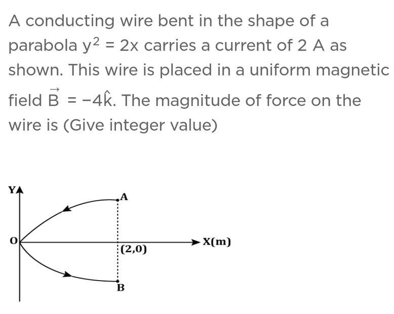

A conducting wire bent in the form of a parabola ##y^2=2x## carries a current of ##2A##. It is placed in a uniform magnetic field of ##-4\hat k T##. Find magnetic force on wire in newtons.
$$d\vec F=Id\vec l\times \vec B $$
Given correct answer is ##32\hat i##
I know the easier method/trick to solve this which doesn't require integration. Since parabola is symmetric about x-axis and direction of current flow is opposite, vertical components of force are cancelled and a net effective length of AB may be considered then ##F=2(4)(L_{AB})=32\hat i##
I was trying to reach the same answer via integration. Thus I proceed :
$$y^2=2x \implies A=(2,2) ; B=(2,-2)$$

Do you remember what the vector dl stands for?

Aurelius120 said:
Small length of wire, correct ?
The line element along the wire. It should represent the small change in the position vector along the wire.
Aurelius120 said:
I took ##dy## as small wire element and then changed ##x## in terms of ##y##. So it should be ok?
No, what you wrote down was not correct. The small change of the position vector when you change y by dy is not given by the expression you wrote down.
Remember the tangent vector?
The general expression for the infinitesimal element of the position vector along a curve in 3D space is $$d\vec{l}=\vec{i}dx+\vec{j}dy+\vec{k}dz$$ from which you can get the correct dl for your case by observing that this parabola lies exclusively in the xy-plane.
Also you know the equation of the parabola so you can find how dy and dx relate by differentiation.

It is obviously correct in the general case. The integral is
\int_A^B d\vec l.
The rest of the expression is just constants and vector structure. Please let the OP think about this.

I have to think it too cause your "obviously" is not so obvious to me. So the integral ##\int_A^B d\vec{l}## along any curve depends only on the edge points A,B of the path of the curve on which we integrate? Not so obvious to me really.
Ok I didn't expect this, the integral $$\int_A^B d\vec{l}$$ is indeed independent of path but the integral $$\int_A^B |d\vec{l|}$$ depends on path. Math can be really unexpected some times.

Does this mean that magnetic force on any weirdly twisted wire in uniform magnetic field can always be reduced to force on a single line of current?
Yes!
