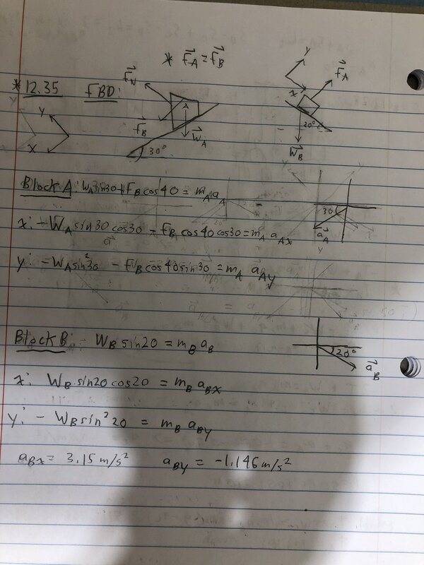

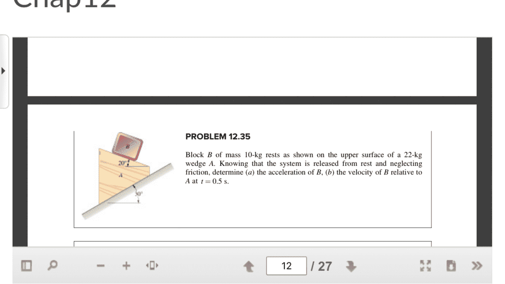

Block B of mass 10-kg rests as shown on the upper surface of a 22-kg wedge A. Knowing that the system is released from rest and neglecting friction, determine (a) the acceleration of B, (b) the velocity of B relative to A at 0.5 s
Newton’s 2nd law
Relative motion
So I’m having trouble with relative motion with moving inclines and I literally can’t find any help online and my prof does a lot of these problems. This is one of my homework problems, can anyone help me with it please.

Try using energy, rather than forces.
PeroK said:
Try using energy and momentum conservation, rather than forces.

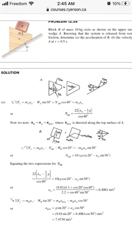

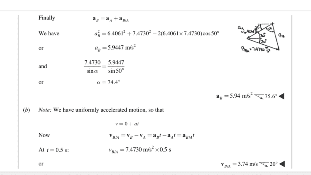

But this for Newton’s 2nd law section so I have to use forces. Do you want to see the solutions and maybe you’ll understand better than me.
The diagrams are hard to read. The idea is that you write down all the forces (obviously) then look for physical constraints: in this case the relationship between the motion of the small block and the large block. Then it's a case of solving the simultaneous equations.
The solution looks light on explanation and heavy on numbers to me.
