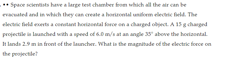

Printed homework problem text about a 15 g charged projectile launched at 6.0 m/s at 35 degrees above the horizontal in a horizontal uniform electric field, asking for the electric force magnitude.
xf = x0 + v0cos(θ)t + (1/2)axt2
yf = y0 + v0sinθt - (1/2)gt2
F = ma
[/B]
I first tried to find the acceleration in the x direction so I could solve for the force
In order to find the time I used the equation for the y coordinate
The initial and final y positions will both be zero so
0 = 0 + v0sin(θ) - (1/2)gt2
t = 2v0sin(θ)/ g = .702 sec
Then I plugged time back into the x equation
2.9 = v0cos(θ)(.702) + (1/2)a(.702)2
a = -2.23
Since I know the acceleration I can find the force by Newtons second law
F = ma
F = .015(-2.23) = -.033 N
It appears that I am a sign off from the correct answer

0 = 0 + v0sin(θ) - (1/2)gt2 t = 2v0sin(θ)/ g = .702 sec
Don't you need to take the square root here?
What do you mean by "a sign off"?

The correct answer is 0.034 N so it looks like I'm getting the negative of the right answer.
And what does the question ask for?
Oh I see. Since it's asking for the magnitude it's just asking for the value and not the sign, right?
Well, I would say it's asking for the magnitude! Which is always a positive number. The negative sign is actually a direction: opposite the direction of motion, in this case.
