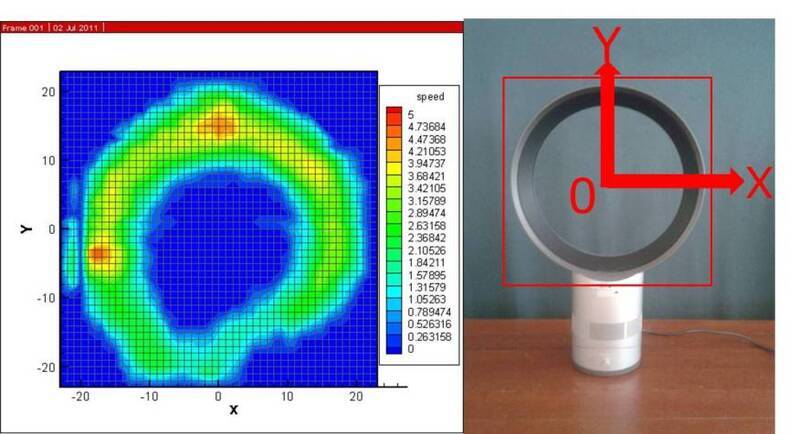

I haven't read the article yet, but that conclusion would go against what other tests have found and fluid dynamics tells us should be true. There is an energy penalty associated with the higher velocity and static pressure creating the jets. There's also a corellation between fan size and efficiency (bigger is better for the same cfm).
We've discussed this topic before. I'll dig into it and see what's going on...

Maybe the velocity distribution across the aperture was ignored. The airspeed could have been measured at one point on the periphery, but then extrapolated across the entire entrained airflow, on the assumption that all air was moving at that speed, when it was actually slower.
Could be. I'm also having trouble with his math. The Vornado 6304 is 9.4" diameter and the Dyson AM06 is 10". The Vornado velocity was measured at 644 fpm and the Dyson at 548 fpm. Airflows listed: 1250 and 1150 CFM. I get 310 and 299 CFM. I think he may have divided by cross sectional area instead of multiplying. He doesn't list the Honeywell size, but I think it's a 12". That would fit with why he got 750 CFM instead of 392 CFM.
That gives corrected efficiencies of:
Dyson: 14.95 CFM/Watt
Vornado: 5.2 CFM/Watt
Honeywell: 9.8 CFM/Watt
In this test the Dyson is more efficient due to its much lower power input than the other fans. It's also much lower than in the other test I linked whereas the Honeywell is identical. They are likely not the same model Dyson but the Honeywell probably is.

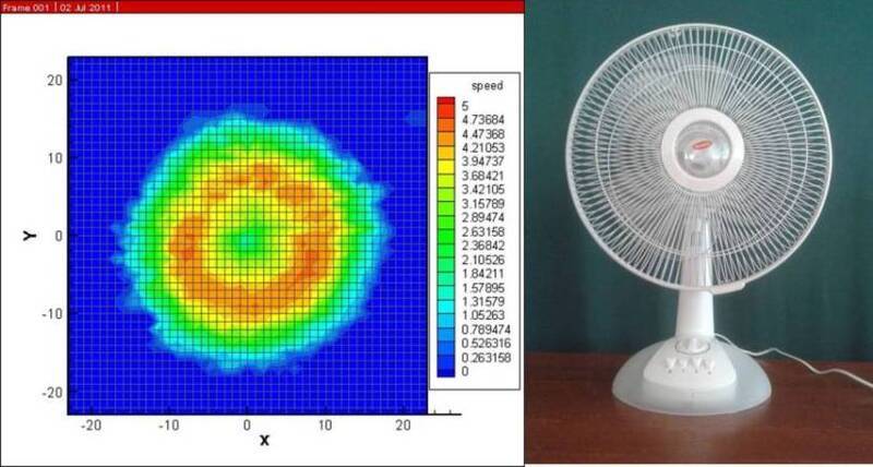

The test I linked measured velocity profiles, and it does indeed show a very uneven velocity for the Dyson vs the conventional fan:
So if I had to speculate, I think the claimed airflow for the DAM in the other test is probably high by a factor of 3-4 due to the improper usage of a single point velocity measurement.
