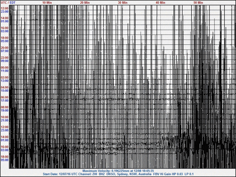

my seismo has only a short time ago stopped hitting the stops ... I was still sleeping when the event occurred and the seismic waves arrived at my location
so I couldn't do a screen save before it started overwriting itself
long period hi gain channel
medium period low gain channel

Ohhh I discovered that buried in the huge signal of the 7.8, there is a M 6.5 off the coast of northern California
Its P wave arrival is at 15:20 UT. where as the P arrival of the 7.8 is at 17:44 UT
so some calc's ... Calif quake origin time 14:50UT ( to nearest minute) and arrival in Sydney Australia at 15:20 (to nearest minute)
P travel time = 30 minutes x 60 = 1800 sec
across Earth's surface distance (from google Earth) 11,834 km
11834 / 1800 = 6.57 km / sec which fits pretty well with the standard models Dave
