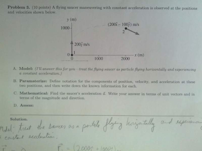

The discussion revolves around determining the acceleration of a saucer using unit vectors, with given initial and final position and velocity vectors. The context involves kinematic equations and their application to vector components.
  • Participants are attempting to find the saucer's acceleration in both unit vector form and in terms of magnitude and direction. Questions are raised regarding the applicability of kinematic equations to vector components versus vectors themselves.

r1=(0m)
r2=(2000i + 1000j)m
v1=(200j)m/s
v2=(200i-100j)m/s
tantheta=vy/vx
v2^2=v1^2+2ax
v2=v1+at
x2=x1+v1t+1/2at^2
Thank you for any help
So what do we have to find??
find the saucer's acceleration in unit vectors and in terms of magnitude and direction.
