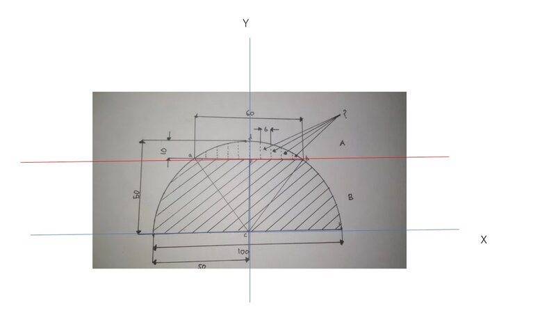

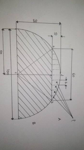

I'm struggling to find an equation to find the distance between two points from the segment to the arc of the circle.
I'm thinking of just using Pythagorean Theorem, but it doesn't work for the segment of a circle. Circle equations.
I have calculated the height of the segment using the Pythagorean Theorem and that's currently where I am right now. I don't seem to find any equations that can help me. Though I might be not trying hard enough or using the wrong words because I'm not really fluent in mathematical terms as you can observe from the details that I provided.
EDIT: I might be in the wrong topics, but whatever.
[tex]\sqrt{50^2-x^2}-10[/tex]where x is distance from c line.

What did you mean by the "distance from c line" sorry? From what point?
Edit. Not -10 but -40. Say x=0how much is it and where is it ?
It should be 10 and it's the sagitta, am I correct?
But I'm still not sure how can you come up with that equation though. Yes it's the equation of a circle but, if I'm wording this correctly, where did you derived this equation from?
Is it from C = πd? Or A = πr^2?
Or even r^2 = x^2 + y^2? Please guide me through it. I don't like not knowing the aspect of "why" from an equation.

I'm trying to find the distance between the chord to the arc of the circle, see question mark I put on the picture I shared. Sorry if I make you confused.
That distance varies depending on the point of the chord you choose. Are you trying to find the distance at points 6 units apart on the chord?

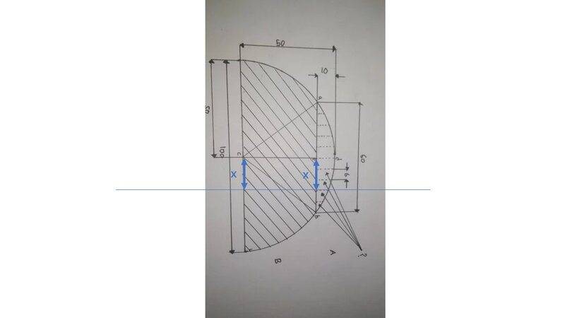

I would rotate your diagram anticlockwise and write down the equation of the chord and the circle. The distance is simply the difference in y-coordinates for a given x-coordinate.

@manareus Do you write down equations of this upper half circle and the red horizontal line ?
Interesting, though I cannot admit that I am able to visualize it.
See post #12.
manareus said:
Hmm I don't know actually my Professor doesn't teach me any chord equations.
In post #12 the chord is a horizontal line. You shouldn't need a professor to tell you the equation of one of those!
