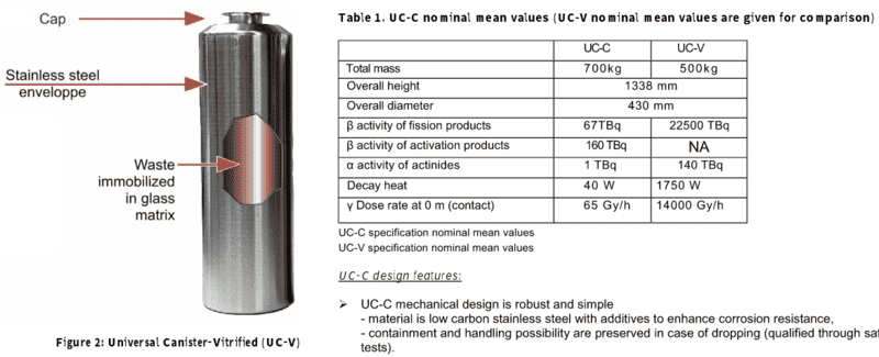

Either way, they are stored in a way that it absolutely does not affect us. People and media talking about the dangers of how much waste is stored on surface awaiting disposal is a myth. It ain't going to do anything to us.
I get it that you are confident that the presence of these above ground containers of nuclear waste in the US represent no danger to you. The OP question, as I interpret it, is why are people like me concerned about such things? One reason might be that your confidence is not particularly reassuring. I do not find calling the dangers "a myth" a convincing argument.
Do you believe these US surface containers are like the ones described for transport in posts #148 and #149? If you do, can you post a link to a reference that makes this clear? If that were the case, I would be somewhat reassured about their safety. Since I do not believe that is the case, I have, for example, some anxiety about a possible "terrorist" attack on that waste.
Regards,
Buzz
