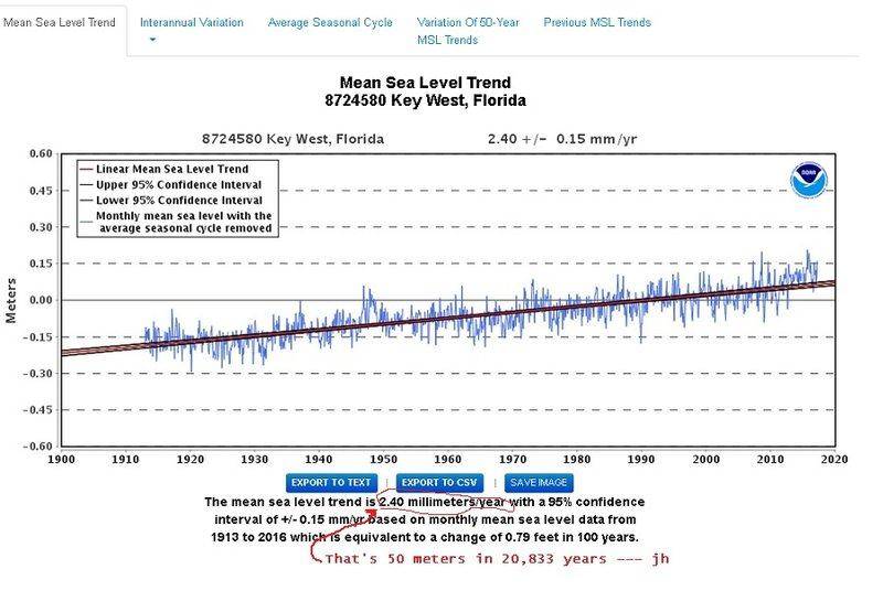

jim hardy said:
40 ??
At 2.4 mm /year , the current rate along US east coast, a meter is 400 years.
Sea level change of 1 meter is not a huge problem.
In Netherlands, postglacial isostatic relaxation currently results in the lowest dry point of the country at 6.76 m below sea level!
I did not read in the news how horribly broken Netherlands is because it had to spend $$$ to build its dikes. Did you?
This is a practical proof that with proper engineering, it is possible to keep rising sea from flooding the land, even with several meters rise.

jim hardy said:
Graph shows data rising above the trend line since 2011. Expect possibility of upwardly revised rate curve with Jason-3 and GRACE data over next few years.
No complacency = no worries. My main concern is political resistance to the expert decisions with regard to removal of waste from flood risk areas. With placement in Yucca Mountain, for example, I understand there would be no risk of radiation exposure to the public while they were enjoying the mountain and the surrounding area. I would like to hear more public education and reassurance in this area of management.
It does that periodically.
But a bit of rise wouldn't surprise me given reports of runoff around Greenland.
Hmmmm it'd be interesting to differentiate this formula
and figure how many tons of water per degree rise should make their way into the atmosphere, ΔP X area of earth?
