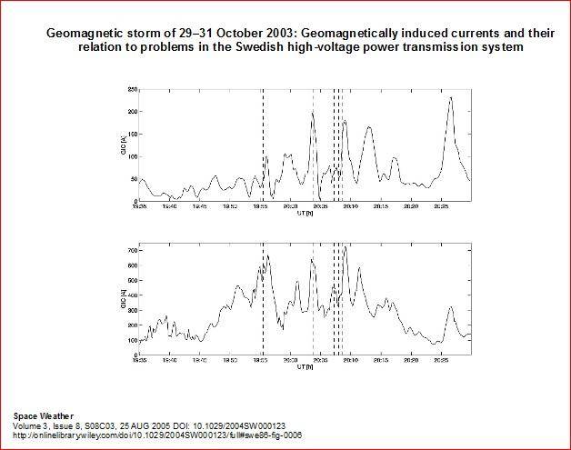

  • #53
Industry is learning as they go. This is an interesting study of a geomagnetic storm in Sweden
http://onlinelibrary.wiley.com/doi/10.1029/2004SW000123/full
it describes "Geomagnetically Induced Currents" (GIC) in the neutrals of a few hundred amps .
