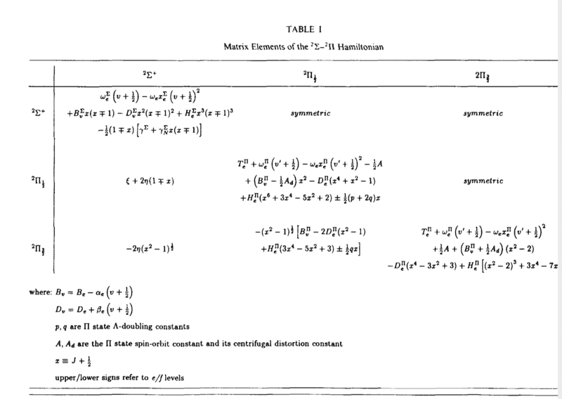

Thanks a lot for this. I was wondering, if I have 2 levels that are very close by and strongly interacting (for example a ##\Sigma## and ##\Pi_{1/2}##) such that I can't use PT i.e. electronic off diagonal matrix element are large (assume that the other electronic states are far away from these two). How should I proceed? It is here where I thought that @Twigg derivation makes sense, as in this case I would actually diagonalize the vibrational levels that I need in the 2 electronic states without using PT at all. But given the Van Vleck transformation, I am not sure how to proceed in this situation i.e. when PT can't be used.

\begin{pmatrix}
a(R) & c(R) \\
c(R) & b(R)
\end{pmatrix}
where, for example ##a(R) = <\Sigma |a(R)|\Sigma >## and it contains stuff like ##V_{\Sigma}(R)##, while the off diagonal contains stuff like ##<\Sigma |L_-|\Pi >##. If we diagonalize this explicitly, we get, say, for the ##\Sigma## state eigenvalue:
$$\frac{1}{2}[a+b+\sqrt{(a-b)^2+4c^2}]$$
Assuming that ##c<<a,b## we can do a first order Taylor expansion and we get:
$$\frac{1}{2}[a+b+(a-b)\sqrt{1+\frac{4c^2}{(a-b)^2}}] = $$
$$\frac{1}{2}[a+b+(a-b)(1+\frac{2c^2}{(a-b)^2})] = $$
$$\frac{1}{2}[2a+\frac{2c^2}{(a-b)})] = $$
$$a+\frac{c^2}{(a-b)} $$
Here by ##c^2## I actually mean the product of the 2 off diagonal terms i.e. ##<\Sigma|c(R)|\Pi><\Pi|c(R)|\Sigma>##This is basically the second order PT correction presented in B&C. So I have a few questions:
1. Is this effective Hamiltonian in practice a diagonalization + Taylor expansion in the electronic space, or does this happened to be true just in the 2x2 case above?
2. I am a bit confused how to proceed in a derivation similar to the one above, if I account for the vibrational states, too. If I continue from the result above, and average over the vibrationally states, I would get, for the ##\Sigma## state:
$$<0_\Sigma|(a(R)+\frac{c(R)^2}{(a(R)-b(R))})|0_\Sigma> = $$
$$<0_\Sigma|a(R)|0_\Sigma>+<0_\Sigma|\frac{c(R)^2}{(a(R)-b(R))}|0_\Sigma> $$
where ##|0_\Sigma> ## is the vibrational level of the ##\Sigma## state (again I assume just one vibrational level per electronic state). This would be similar to the situation in B&C for the rotational constant in equation 7.87. However, if I include the vibration averaging before diagonalizing I would have this Hamiltonian:
\begin{pmatrix}
<0_\Sigma|a(R)|0_\Sigma> & <0_\Sigma|c(R)|0_\Pi> \\
<0_\Pi|c(R)|0_\Sigma> & <0_\Pi|b(R)|0_\Pi>
\end{pmatrix}
If I do the diagonalization and Taylor expansion as before, I end up with this:
$$<0_\Sigma|a(R)|0_\Sigma>+\frac{<0_\Sigma|c(R)|0_\Pi><0_\Pi|c(R)|0_\Sigma>}{(<0_\Sigma|a(R)|0_\Sigma>-<0_\Pi|b(R)|0_\Pi>)} $$
But this is not the same as above. For the term ##<0_\Sigma|c(R)|0_\Pi><0_\Pi|c(R)|0_\Sigma>##, I can assume that ##|0_\Pi><0_\Pi|## is identity (for many vibrational states that would be a sum over them that would span the whole vibrational manifold of the ##\Pi## state), so I get ##<0_\Sigma|c(R)^2|0_\Sigma>##, but in order for the 2 expression to be equal I would need:
$$\frac{<0_\Sigma|c(R)^2|0_\Sigma>}{(<0_\Sigma|a(R)|0_\Sigma>-<0_\Pi|b(R)|0_\Pi>)} =
Which doesn't seem to be true in general (the second one has vibrational states of the ##\Pi## states involved, while the first one doesn't). Again, just to be clear by, for example, ##<0_\Sigma|a(R)|0_\Sigma>##
I mean ##<0_\Sigma|<\Sigma|a(R)|\Sigma>|0_\Sigma>## i.e. electronically + vibrational averaging.
What am I doing wrong? Shouldn't the 2 approaches i.e. vibrational averaging before or after the diagonalization + Taylor expansion give exactly the same results?
I read again what you are trying to do here. Your first expression for the Hamiltonian ("full, in electronic space") is actually the potential energy matrix for the nuclei in a diabatic representation. This makes sense, as the Sigma and Pi states are of different symmetry as long as Lambda coupling etc are negligible. Hence c(R) is also very small and only non-negligible at ##R_\mathrm{is}## where the two curves a and b intersect ##a(R_\mathrm{is})= b(R_\mathrm{is})##. Especially, c(R) may be set to the constant value ##c(R_\mathrm{is})##.
Nevertheless the diagonalization of the potential energy matrix, which yields the adiabatic potential, has dramatic effects on both the electronic and the nuclear wavefunctions, as it interchanges the states upon crossing the point ##R_\mathrm{is}##. Let the potential energy matrix be ##V(R)##, then this matrix is diagonalized by a unitary transformation ##U^\dagger(R)V(R)U(R)=W(R)##, where ##W(R)## is the diagonal matrix of the adiabatic potential energy surfaces. However, this transformation does not diagonalize the nuclear hamiltonian ## T_\mathrm{nuc}+V(R)##, as ##U(R)^\dagger T_\mathrm{nuc}U(R)-T_\mathrm{nuc}## is not zero and becomes very large at ##R_\mathrm{is}##.
So the correct recipe is to use the vibrationally averaged (averaged before diagonalization) Hamiltonian setting ##c=c(R_\mathrm{is})##, so that the matrix elements of c become proportional to Frank-Condon factors:
##<\nu_\Sigma|T_\mathrm{nuc}+a(R)|\nu_\Sigma>+c^2\sum_{\nu_\Pi}{(R_\mathrm{is})\frac{|<\nu_\Sigma|\nu_\Pi>| ^2}{(<\nu_\Sigma|T_\mathrm{nuc}+a(R)|\nu_\Sigma>-<\nu_\Pi|T_\mathrm{nuc}+b(R)|\nu_\Pi>)} ##
To obtain the same result in the adiabatic representation (i.e. first diagonalizing the potential energy matrix, then averaging over vibrational states), one has to evaluate the non-adiabatic couplings using the Hellmann-Feynman theorem .

Why is this a sentiment? I just tried to clarify why using something like diagonalization of a Hamiltonian via the van Vleck transformation might yield the same result as the simpler vibrational averaging proposed by Billket in his concrete example.
In this paper, Table I, they show something very similar to what I am trying to describe. The only difference is that they use 3 electronic levels, but they still use just only one vibrational level for the same of simplicity. And they do a mix of B&C and @Twigg. They do a Van Vleck transformation on the diagonal, but they average the vibrational levels on the off-diagonal, before fully diagonalizing the Hamiltonian (which they do later), which actually makes me even more believe that @Twigg's derivation and B&C are equivalent.
  • #148
I fear I don't have access to this paper.
  • #149
Sorry about that! Here is a screenshot of that table (not sure how to attach the paper here). The table is cut on the right side a bit from the paper (it's quite an old paper).
  • #150
BillKet said:
##c(R)## does contain ##T^N##. The way I build this Hamiltonian is by finding the eigenstates of ##H_{el}## and we do have that ##<\Sigma|T^N|\Pi>\neq 0##
Does it? As Sigma and Pi have different symmetry, ## <\Sigma(R)|\Pi(R')>=0## for all R and R', hence also
## <\Sigma(R)|T^N|\Pi(R)>=0##.
