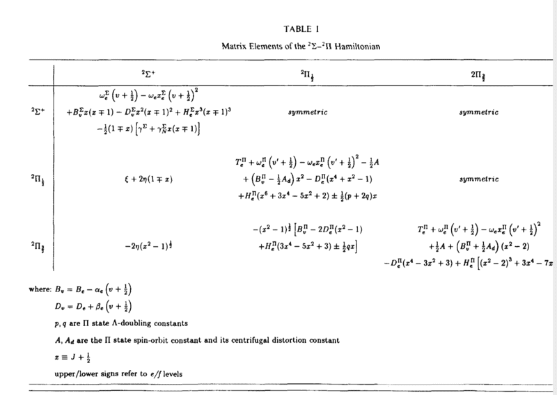

Sorry about that! Here is a screenshot of that table (not sure how to attach the paper here). The table is cut on the right side a bit from the paper (it's quite an old paper).
What is ##\xi## and ##\eta##?
Sorry! ##\xi## is the SO hamiltonian term and ##\eta## the rotational one. So for example ##\xi = <\nu_\Sigma|<\Sigma|H_{SO}|\Pi>|\nu_\Pi>## and ##\eta = <\nu_\Sigma|<\Sigma|H_{rot}|\Pi>|\nu_\Pi>##
Ok, so they actually use the vibrational averaging approach in the diabatic representation of the Pi and Sigma states.
