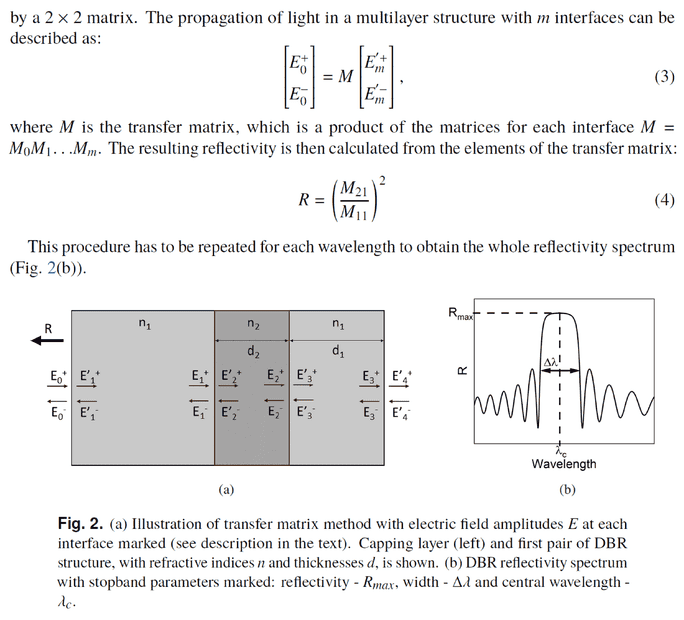

If you look right around figure 3 on around the 3rd page, it has a formula ## l_{coh} \approx \frac{\lambda^2}{2 \, \Delta \lambda } ## that seems to apply in general. From what I can deduce from this formula, and I mentioned this in post 27, it appears to me that you are both right.
To be able to predict or accurately model the multi-layered interference filter is still a little bit of a puzzle though. If the coherence length of the broadband sunlight is somewhere around one micron, (and I think we are now all in agreement on this), it remains an open item whether the type of filter described by the OP should work in principle, even though we have experimental proof that it does. The source that you linked in post 10 seems to be our best reference right now, but I found the details of their numerical methods a little difficult to follow.
Meanwhile I still could enjoy getting some feedback on posts 7,8, and 11. I mentioned that it took me a number of years to finally recognize the interference is essentially the result of two sinusoidal sources incident from opposite directions on a single interface for the Fabry-Perot case. I first saw the Fabry-Perot effect as an undergraduate student in 1975, and I studied the calculations with the multi-layer thin films as a graduate student in 1979. I encountered the Fabry-Perot effect numerous times at the workplace. There always seemed to me that there was something missing in the standard explanations, which I finally figured out in 2008-2009 by trying some calculations and computing the interference effects (using the Fresnel coefficients) when there are two sinusoidal sources incident from opposite directions onto a single interface. I urge you to try it for yourself and/or read my Insight article listed in post 7. I think you might find it worth your while.

Calculating a multilayer interference filter you need to split wavelength range into arbitrary amount of narrow ranges and handle those
1) like every has infinite coherence length
and
2) ranges are independent from each other (no cross correlation).
At least compare to the thickness of multilayer coating the coherence length of any very narrow intervals can be considered as >> then thickness. At every of intervals all layers are involved into interference.
That would be a practical approach delivering your reasonable result.

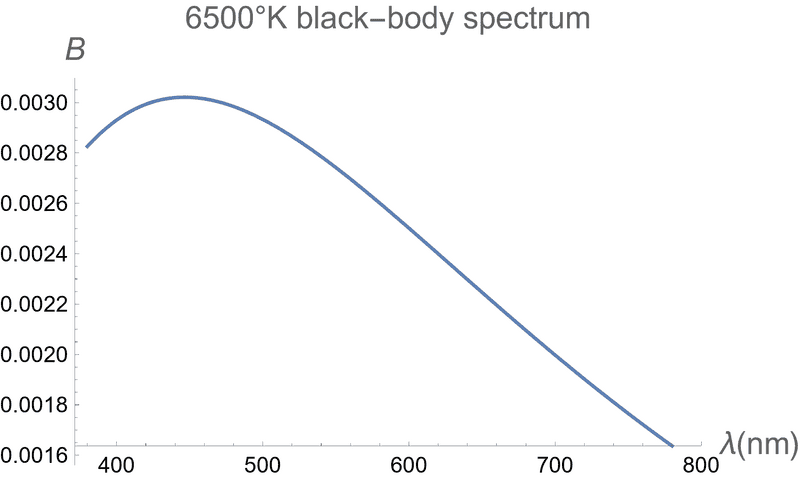

I believe our fundamental disagreement stems from the distinction between narrowband vs. wideband optical filters. The Fabry-Perot etalon talked about by @Gleb1964 is an optical cavity whose spatial extent (mms to cms) and reflectivity is carefully engineered to employ interference to pass what is (almost) a single specific wavelength, and so requires coherence-lengths on the order of at least mms to cms to function. In other words, an etalon is an ultra-narrowband filter. When illuminated by the incoherent spectrum of sunlight, it selects-out from that spectrum only those particular wave-trains of sufficient length and precise frequency and blocks the rest. As such, the coherence-length of the transmitted radiation says precisely nothing about the source (sunlight), rather it is simply a characteristic of the etalon itself. This is obvious since if we replace the source by a highly-coherent laser of the appropriate wavelength and intensity, the transmitted light is unchanged. Thus, an observer with access only to the output from the etalon cannot distinguish whether its input is the broadband sun or the narrowband laser. Thus, the light emerging from an etalon bears no relation to the average coherence-length of the broad solar spectrum.
In contrast, the OP's question is aimed at the design of wideband thin-film filters intended to pass sunlight over a broad part of its spectrum. Particular examples are antireflection (AR) coatings that act as UV-IR cutoff filters, passing only visible light for photography, eyeglasses and the like, and AR coatings for solar cells to match the transmitted solar radiation to the power-band of those cells, while reflecting undesirable radiation outside that band. Here is a reference describing such a coating for cadmium-telluride cells: Multilayer Broadband Antireflective Coatings.... In section II the authors state:
I now examine how the highlighted restriction impacts the design of the coating:
From the wavelength range, I can use the relation ##l_{coh}\approx\frac{\lambda^2}{2 \,\Delta\lambda }## given by @Charles Link to estimate the coherence-length to be ##l_{coh}\approx 625^2/2/\left(850-400\right)=434\text{nm}##. Note that ##l_{coh}## falls into the solar longitudinal-coherence range ##170-900\text{nm}## that I quoted in post #17. This coherence length is to be compared with the ##\text{Optical Thickness}\equiv\text{(Refractive Index)}\times\text{(Physical Thickness)}## of each layer, as well as to the entire 4-layer stack:
\begin{matrix}
\text{Material} & \text{Index} & \text{Thick.(nm)} & \text{Opt. Thick.(nm)} & \text{< 434nm?}\\
\hline \text{SiO}_2 & \text{1.45} & \text{94.12} & \text{136.47} & \text{Yes}& \\
\hline \text{ZrO}_2 & \text{2.13} & \text{133.99} & \text{285.20} & \text{Yes}& \\
\hline \text{SiO}_2 & \text{1.45} & \text{30.40} & \text{44.08} & \text{Yes}& \\
\hline \text{ZrO}_2 & \text{2.13} & \text{18.81} & \text{40.07} & \text{Yes}& \\
\hline & & \text{Total OT:} & \text{505.83} & \text{No}
\end{matrix}
Clearly, even though the optical stack-height exceeds the coherence-length ##l_{coh}\,##, this filter functions because the optical thickness of each individual layer is less than ##l_{coh}\,##, completely consistent with the highlighted statement above. Thus, I claim that the declaration:

Let's start by estimating the full-spectrum longitudinal coherence-length. Taking the wavelength-range of visible light to be ##380\mathrm{\mathrm{n}m}\equiv\lambda_{1}\leq\lambda\leq\lambda_{2}\equiv780\mathrm{\mathrm{n}m}##, its easy to see that ##\lambda_{2}-\lambda_{1}\equiv\Delta\lambda\sim\lambda\,## implying that the small-difference approximation breaks down. Therefore, here I'll calculate ##l_\text{coh}## from a formula that's more appropriate to a wideband spectrum (http://electron6.phys.utk.edu/optics421/modules/m5/coherence.htm) :$$l_{coh}\equiv\frac{\lambda_{1}\lambda_{2}}{2\pi\left(\lambda_{2}-\lambda_{1}\right)}=118\mathrm{nm}\tag{1}$$The window is illuminated by atmospheric-filtered sunlight as it reaches ground level, which I approximate as ##T=6500°\text{K}## black-body radiation ##B##:
$$B\left(v\right)=\frac{Nv^{3}}{\exp\left(\frac{hcv}{kT}\right)-1}\tag{2}$$where ##v\equiv1/\lambda## is the radiation wavenumber and ##N## is a normalization constant chosen to make the area under the spectral-curve unity: ##\intop_{1/\lambda_{2}}^{1/\lambda_{1}}dv\,B\left(v\right)=1##:
Next I write down the expression for the power transmission-coefficient ##T## of the glass slab:$$T\left(\tau,n,v\right)=\frac{8n^{2}}{n^{4}+6n^{2}+1-\left(n^{2}-1\right)^{2}\cos\left(4\pi\,n\,\tau\,v\right)}\tag{3}$$This comes from solving JD Jackson, Classical Electrodynamics, problem 7.2 (complete solutions can easily be found online). Finally, I multiply (3) by (2) and integrate over ##v## to find the total power ##P_T## across the spectrum that is transmitted through the window:$$P_{T}\left(\tau,n\right)=\intop_{1/\lambda_{2}}^{1/\lambda_{1}}dv\,B\left(v\right)\,T\left(\tau,n,v\right)\tag{4}$$Choosing ##n=1.70## and repeatedly evaluating integral (4) numerically for increasing thickness ##\tau## yields the resulting graph:
What this tells me is that the total range of possible slab thicknesses ##\tau## is divided roughly at ##\tau\sim l_{coh}## into two subranges that can be summarized by:$$
P_{T}\left(\tau\right)=\begin{cases}
\sim100\% & \tau\lesssim l_{\text{coh}}\text{ (high-inteference subrange)}\\
\sim P_{T}\left(\infty\right) & \tau\gtrsim l_{\text{coh}}\text{ (low-inteference subrange)}
\end{cases}
\tag{5}$$I do acknowledge what you've both been emphasizing: one can choose any specific wavelength from a bright, incoherent source, like the sun or an incandescent bulb, and always find coherent wave-trains of more than sufficient length to get through any etalon. But based on the above analysis, I fail to see how this fact has any bearing on the design and performance of wideband multilayer interference filters intended to deliver maximum intensity across the band. Instead, I think that the optimal configuration for such a filter is achieved by striving to keep the optical thickness of each layer less than the broad-spectrum coherence-length; i.e., well under a micron. That's why I continue to maintain that the submicron-scale coherence-length of sunlight is quite relevant for the synthesis and operation of wideband thin-film filters.

The other item that we might still need to answer is whether a stack of layers will work where the thickness of the stack greatly exceeds the coherence length, provided the thickness of each layer is less than the coherence length. I think the answer to that is yes. Edit: and I see @renormalize in post 10 above is in agreement with this.[Edit: I do see post 42 that doesn't seem to be real clear on this, and may be in disagreement=the highlighted "provided that the thickness is less than the coherence length"].
and reading the OP again, they ask how does it work if the stack is much thicker than the coherence length? We seem to be in agreement on this that it does work, even though the thickness of the stack greatly exceeds the coherence length. There doesn't seem to be any major restriction here.
Edit: I need to add something to the above. The H alpha type etalon, mentioned by @Gleb1964 , post 12 above , even though it is a comb filter blocks perhaps 95 % or more of the broadband sunlight. So this comb filter does have a practical use, but it does not transmit a broad passband and block a broad passband, which is what I think the OP is trying to do.
