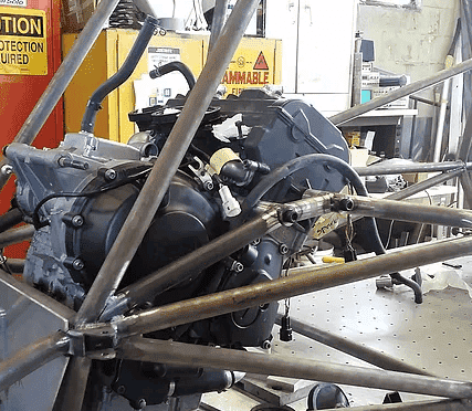

This is just one of the numerous designs I've found online. Do you mind explaining how the engine torque creates stress in the member connecting the engine to the rest of the chassis using this example?
(I don't have a definite design for now)

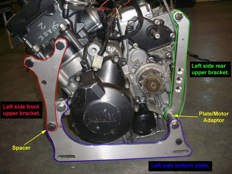

It's a Yamaha R6
is this what you meant?
That's a start. Nice bracket fabrication, BTW. What about the other side? How are you going to attach those mounting brackets to your kart frame?
The R6 is about 110hp, right? That kart is going to be a handful... :smile:
