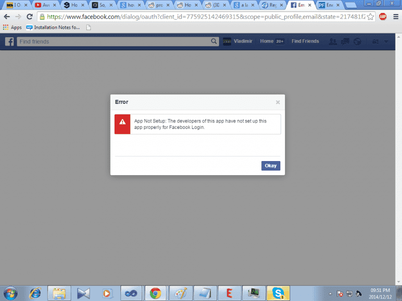

Hi all, I'm currently working on a 3D game and am in the city development phase (its done procedurally). The issue is is that once I get to 22 000 buildings (80 000-100 000 models roughly) it causes a drop to 5fps(frames per second) (even with collision detection off). I'm using instancing to speed things up, octrees for the collision detection etc., I've tried drawing things only within your view frustum but the BoudingBox-Frustum intersection for each building slows it down too much. how do people in the industry still get 60fps with such large maps? Any ideas on techniques ignore the image was an accident

Is this 3D game for Facebook?

  • This is not C / C++ and OpenGL / DirectX, but something running on Facebook. I have no idea of how much overhead this adds.

I'm pretty sure you can build facebook games in anything as long as they integrate with the facebook API.

I think you are right, but still, it is running on a web page, right? That must add some (not insignificant) overhead to the game.

Facebook games aren't hosted on facebook servers. Pretty much all the facebook game API does is perform authentication and keep track of friends, scores, achievements, posting to walls.. this sort of stuff. Facebook servers have nothing to do with the graphics rendering.
