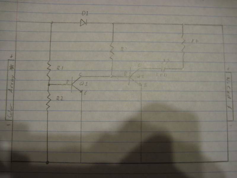

Yes, I will be using a diode. Here are the schematics I'm using:

Referring to the schematic, then, will everything be okay, considering that I will be using a ~6 volt solar array instead of a ~4.5 volt one?

The circuit looks OK, but you would have to avoid overcharging the batteries. Measure the current when you first install it to see how many hours you will need to use it to charge the batteries.
I would use a resistor in series with the LED. About 100 ohms to start with and see if that gives you enough brightness. You can probably add more LED/ resistor combinations in parallel if the battery can cope with it.

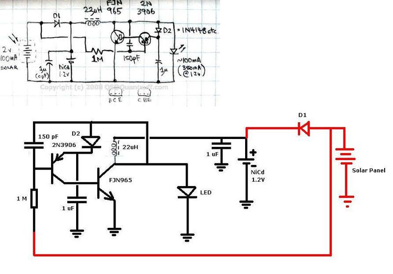

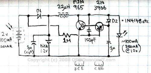

Just for interest, here is another similar circuit:
It apparently gives good light from an almost flat battery.

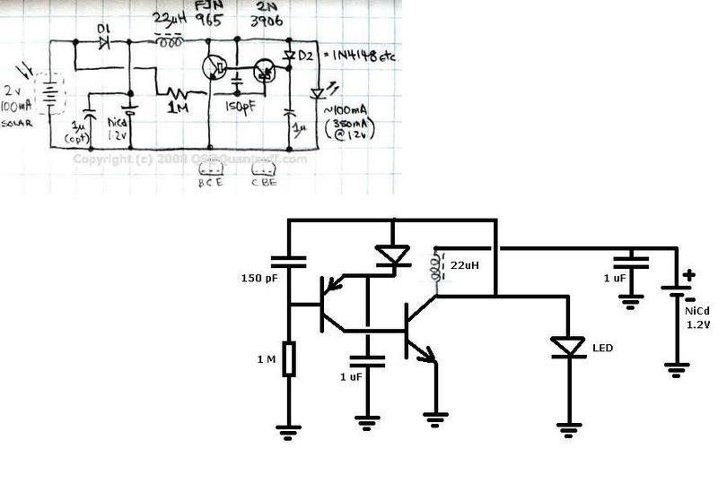

Attachment 22760
How does it accomplish that?
That circuit is an oscillator which generates a higher voltage than the battery voltage to run the LED. White LEDs need 3.5 volts to run them, so you can't run them on 1 or 2 NiCd batteries.

Yes, or you could have a look at that circuit I sent you.
It uses the voltage developed across the inductor to generate more voltage than the battery supplies and this is then used to power the LED.
It is a very clever circuit.
I can't really read that schematic. Is that coil-looking thing the oscillator? How does that work, and what kind is needed? How many batteries does it need?
I have redrawn the oscillator part of the circuit to look more conventional.
Because the original contains a copyright message, I have kept it on the page.
This circuit should not be used for commercial purposes.
The 1 M resistor is fed from the solar panel, so when this is grounded the circuit will oscillate. When the panel is operating, the oscillator is not oscillating and is also not drawing any current. This seems to be the function of the diode in the emitter of the PNP transistor.
I don't have much experience with reading electrical schematics, so I am little confused about a few things.

1. What is the curly-looking thing labeled "22uH"?
That is an inductor. 22 microhenries. Good electronic stores might carry them.
2. There are no labels on the transistors in either circuit. I can tell that one is PNP and one is NPN but I can't tell which, nor what type is needed.
Yes, there are. 2N3906 is the PNP and FJN965 is the NPN. The first is quite readily available, but I have never heard of the FJN965.
3. What's a "1 M" resistor?
1 megohm. One million ohms.
4. The original schematic shows the solar panel and D1 and D2 diodes. Yours only shows one diode and no solar panel.
EDIT: Oh, wait, you had only redrawn the oscillator part. I'm still rather confused though, because I'm not sure how yours fits into the big picture. If it's not too much trouble, could you draw the full circuit with labels? That would be great.
Also, this oscillator only gives 1.2 volts to the LED. If I needed more, could I add batteries in series with the one shown without any further alteration of the circuit?
No, it gives more than 3.5 volts because it lights up a white LED. It is in the form of pulses.
Here is the circuit again with the solar panel in it.
Oh; thanks for the schematic!
