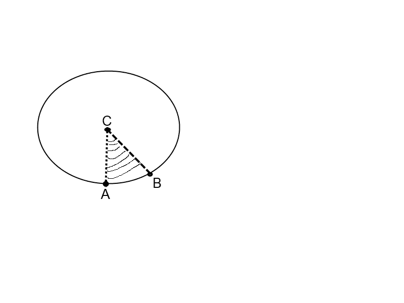

Here is my very quick interpretation of the "Rotating Disk" with some "visual aids" that describes one picture of the non-euclidean space.
First look at the wiki diagram of the Langevian syncrhonization.
The red line indicates the worldline of one observer on the disk, say "point 0" in that Reden paper.
The blue line is a curve that you get by Lorentz synchronizing observers in each of the local comoving inertial frames at the edge of the disk - it's orthogonal to the congruence of red lines representing the worldlines at various points around the disk.
Let's call the lower interesection of the red and blue lines point "A" and the upper intersection of the red and blue lines point "B".
we see that "A" and "B" occur at different times. THis is what's causing the confusion.
Tartaglia mentioned a key important insight - that our "spatial" surface is a quotient space.
The wiki definition of this is:
In topology and related areas of mathematics, a quotient space (also called an identification space) is, intuitively speaking, the result of identifying or "gluing together" certain points of a given space. The points to be identified are specified by an equivalence relation. This is commonly done in order to construct new spaces from given ones.
How do we construct this space? How do we represent this space on our diagram?
Well, we know it contains the winding outer blue line. That's represents the circumference of our space.
If we imagine a slightly smaller cylinder, of smaller radius, it has a winding blue helical line around it, which is also in our space.
Finally we come to the center, which is just a point.
Where is the point located on our diagram? In the center, obviously, but where on the z axis - at what point in time?
I believe the answer is conventional, so I chose the "obvious" location, midway on the z axis between A and B.
As much as we might like to use Einstein clock synchronization throughout - we can't. Hence, the need for a non-conventional radial clock synchronization.
When we put it all together, we visualize something like the screw thread, below, but oriented vertically to match the first diagram.
This is our "space".
If we smash it flat, we get somethign like the attachment below. It's a circle, with a bit of an extra piece glued onto it.
Point A on our diagram represents point A on the Langevian cylinder, the lower intersection of the red and blue lines. Point B on our diagram represents point B on the Langevian culinder, the upper intersection of the red and blue lines.
Now, we "glue" together (in the sense of our definition of a quotient space) the dotted line to the dashed line on our diagram. And that's our space.
In this particular representation, our space is flat everywhere (we made it out of flat paper), it's the "gluing operation", the identification of points, that makes the space non-Euclidian.
