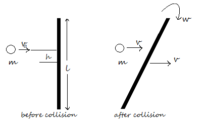

A mass ##m## travels in a straight line with velocity ##v_0## perpendicular to a uniform stick of mass ##m## and length ##l##, which is initially at rest.. The distance from the center of mass of the stick to the path of the traveling mass is ##h##. Now the traveling mass ##m## collides elastically with the stick, and the centre of the stick and mass ##m## are observed to move with equal speed ##v## after the collision. Assuming the traveling mass can be trated as a point mass, and the moment of inertia of the stick about its centre is ##I=\frac {ml^2}{12}##, calculate the distance ##h##.

But I cannot calculate the angular momentum of the stick.
Is it $$((\vec L_{stick})_f=I\vec \omega + m\vec v ({\frac l 2}-r)$$
If someone has any suggestion, it might be helpful.

Think about what origin you are using to calculate the angular momentum of the system. The stick will conceivably have angular momentum due to its rotation about its center of mass and also due to the motion of its center of mass. The ball, likewise, may have angular momentum after the collision because it's still moving.
One mistake I noticed was that angular momentum is ##\vec{r}\times\vec{p}##. You have the two vectors reversed in your expression for the angular momentum of the ball.

You have to be a bit careful about choosing reference axes for dynamics problems. The safest is to choose a fixed point in space. In this case, the initial position of the stick's centre would be simplest.
Both the initial and final angular momenta of the ball can be computed by application of ##\vec L=\vec r\times\vec p##.

What I'm having difficulty in understanding is that since the ball strikes the stick at ##h## off the centre of the stick, where will the equal and opposite torque work? Is it ##\frac l 2## or ##h##?
From the conservation of linear momentum, I obtained $$v_0=2v$$
From the conservation of total kinetic energy, I obtained $$I{\omega}^2=m({v_0}^2-2v^2)$$
Which gives, $$I{\omega}^2=m[(2v)^2-2v^2]$$
Substitution of the moment of inertia of the stick $$I={\frac {1} {12}}ml^2$$ gives
$${\frac {1} {12}}ml^2{\omega}^2=2mv^2$$
$$\Rightarrow \omega=2{\sqrt 6} {\frac v l}$$
So, if the opposite torque acts at ##h##, the angular momentum conservation gives $$\sum {\vec L_i}=\sum {\vec L_f}$$
$$\Rightarrow mv_0 h=mvh+I\omega$$
$$\Rightarrow m(2v) h=mvh+{\frac {1} {12}}ml^2{\sqrt 6} {\frac v l}$$
$$\Rightarrow mvh={\frac {1} {\sqrt 6}}mvl$$
Which gives $$h={\frac {1} {\sqrt 6}}l$$
Which is the desired answer.But I'm still not really clear about the idea of the distance where the opposite torque work.

You do not need to care. The equal and opposite torques are internal to the system.
But if you want to break it into ball and stick as separate systems then...
VSayantan said:
the equal and opposite torque acts the other end
... the equal and opposite impulses act at the point of impact. Not sure it means anything to ask where torques act. The torque from a force depends on your choice of reference axis, and to compare them you would necessarily use the same axis for both.

In addition to what haruspex said, there is no equal and opposite torque on the stick. If there were, the net torque on the stick would be 0, and the stick would not end up rotating about its center of mass.
Newton's third law implies that when the ball exerts a force on the stick, the stick exerts an equal and opposite force on the ball. Because the forces act on different objects, the corresponding torques are on different objects. The torque on the stick gets it rotating after the collision while the torque on the ball just slows it down.
