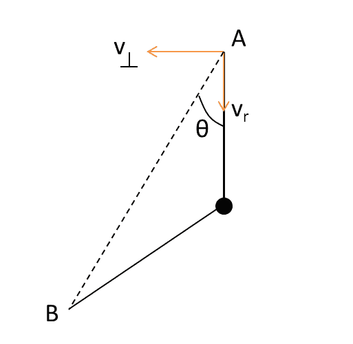

Let A be the point when the string slacks and B be the point when the string becomes taut again. After the string slacks, the motion is along the straight line AB.
From trigonometry, ##AB=2l_0\cos\theta##. Also,
$$\tan\theta=\frac{v_{\perp}}{v_r}=\frac{4v_0}{l_0\omega}=2\,\,\,\,\, \left( \because v_0=\frac{l_0\omega}{2}\right)$$
We are asked to find ##\tau_0##,
$$\tau_0=\frac{\ell(AB)}{\sqrt{v_r^2+v_{\perp}^2}}=\frac{2l_0\cos\theta}{\frac{\sqrt{5}l_0\omega}{2}}\,\,\,\,(\text{from}\,(*))$$
$$\Rightarrow \tau_0=\frac{4}{\sqrt{5}\omega}\frac{1}{\sqrt{5}}=\frac{4}{5}\sqrt{ \frac{m}{k}}$$
Can somebody please confirm these? I don't have the final answers. Thanks!

That all looks good to me. Nice work.
For part (i) they ask for the ratio of initial KE to total energy, which you can easily get from your results.
