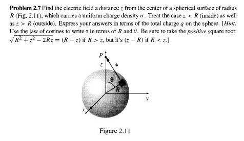

Hello
i want to solve this problem via another approach
question:
Figure 2.11: a sphere of radius R centred at the origin with a point P at distance z along the z-axis, and angle theta marked at the centre, with r drawn from P to a point on the surface.

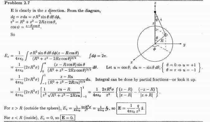

Book Solution:
Handwritten-style textbook solution, Problem 2.7: electric field of a spherical shell via Coulomb integral with cos(theta) substitution, giving E = q/(4 pi eps0 z^2) for z > R and E = 0 for z < R.

so the output is that is different between this way and the book solution
Handwritten or typeset formula for electric field E = (sigma r^2 h) / (epsilon (r^2 + h^2)^(3/2)) times a z-hat unit vector, giving the field of a uniformly charged disk on its axis.
what is my problem? and how can find the electric filed in out and in of spherical surface via this approach?
