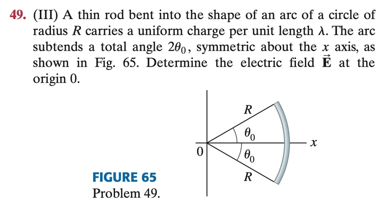

microdosemishief
Please see image
Coulomb's Law (dE=kdQ/r^2)
My attempt: due to symmetry along x-axis, net E is only along x^hat.
dQ = λ dl = λ (R dθ)
for each dl, the x component of distance from dl to the origin is Rcos(θ)
Hence, E_x = \int_{-θ_0}^{θ_0} k(λ R dθ)/(Rcos(θ)^2 = kλ/R \int_{-θ_0}^{θ_0} sec(θ)^2 dθ = 2kλ/R tan(θ_0) along negative x^hat
But the correct answer has sin(θ_0) instead of tan(θ_0)

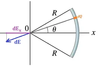

For the element of charge ##dQ## shown, how would you write an expression for ##dE## at the origin?
How would you write the x-component of ##dE##?

What was your reason for writing the denominator of the integrand as ##(R\cos \theta)^2##? This is not correct.
To find ##E_x## due to the entire charge ##Q##, you need to understand that ##E_x = \int dE_x## where ##dE_x## is the x-component of the field vector ##\overrightarrow{dE}## due to an arbitrary element of charge ##dQ##.
So, first, think about the vector ##\overrightarrow{dE}## at the origin produced by ##dQ##. You should draw the vector ##\overrightarrow{dE}## at the origin in a diagram and write an expression for the magnitude, ##dE##, of this vector.
Next, think about how you can write an expression for the x-component, ##dE_x##, of the vector ##\overrightarrow{dE}##. Then you will be ready to set up the integration ##E_x = \int dE_x##.

No. Let's forget dEx for now. Just concentrate on dE.
dE is the magnitude of the electric field vector dE at the origin O produced by the charge dQ in the diagram in post #2. In the general formula dE = kdQ/r2, what would you use for the distance r in this case?
R

Your answer is wrong because you can't get the x-component dEx by replacing R in the denominator of dE by Rcosθ.
Note that Rcosθ < R when θ≠0. So, kdQ/(Rcosθ)2 is greater than kdQ/R2 when θ≠0. That is, your expression for dEx is greater than the expression for dE. But the component of a vector cannot be greater than the magnitude of the vector.

I don't understand why you say that "dEx is Rcosθ distance away". Both dE and dEx are associated with the same point, namely the origin:
In what sense is dEx located a distance Rcosθ away?

Your answer $$E=\frac{2k\lambda}{R}\tan\theta_{0}$$ is wrong because for a quarter circle ##\left(\theta_0=90^{\circ}\right)## it implies that the electric field at the center will be infinite which doesn't make sense. The field is finite in the range ##0<\theta_0<2\pi.##
##Rcos\theta## is x component of vector ##\vec{r}## not ##d\vec{E}##, where by ##\vec{r}## i mean vector that starts at the origin, and points do ##dQ##.

The electric field from a charge element ##dq=\lambda d\theta## is a vector ##d\vec E## which has magnitude $$dE=\frac{kdq}{R^2}=\frac{k\lambda d\theta}{R^2}$$ because the distance between the element and the point of interest is ##R##. All elements ##dq## are at the same distance ##R## from the center of the arc. The magnitudes of their contributions ##d\vec E## are the same but their directions are different. To find the net field you need to add all elements ##d\vec E## as vectors, which means that you add all the x-components together and, separately, all the y-components together. That's called superposition.
So what are ##dE_x## and ##dE_y## if the magnitude is ##dE## as given above?
On edit
If you insist on using vector ##\mathbf r##, you can start formally from the general expression for the electric field at position ##\mathbf r## due to a point charge ##Q## at position ##\mathbf r'##, $$\mathbf E=\frac{kQ(\mathbf r-\mathbf r')}{|\mathbf r-\mathbf r '|^3}.$$ Then substitute
##\mathbf r=0##; ##~\mathbf r'=R\cos\theta~\mathbf{\hat x}+R\sin\theta~\mathbf{\hat y}##; ##~Q=\lambda d\theta## and integrate. You will get the same answer.
