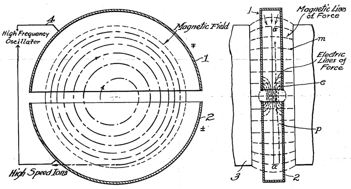

The electric field inside a cyclotron is effectively zero due to the configuration of the Dees, which are conducting plates at the same potential. The cancellation of the electric field occurs because the particles are surrounded by these plates, resulting in negligible electric fields at their location. Acceleration of particles happens in the gap between the Dees, where an alternating RF electric field exists, allowing particles to gain energy as they cross the gap at the correct timing. This timing is crucial, as it must synchronize with the RF frequency, which is determined by the mass of the particles and the magnetic field strength.
- Understanding of cyclotron operation principles
- Knowledge of RF (Radio Frequency) electric fields
- Familiarity with magnetic fields and their effects on charged particles
- Basic concepts of electric potential and field cancellation
