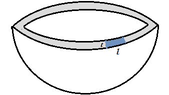

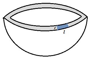

For a patch length ##l## and thickness ##t## as shown, the area of the patch is ##A = lt##.
Diagram of a hemispherical bowl with a shaded band along its rim, labeled t for thickness across the band and l for the length of a highlighted patch along it.
So, the force required to disjoin this area is ##F = cA = clt##. Thus, the force per unit length is ##F/l = clt/l = ct##. Since ##c## and ##t## are the same for the two spheres, the force per unit length required to split the sphere is the same for the two spheres.
