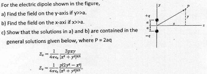

1. Homework Statement
I can't use voltage, nor polar coordinates (got to stick with cartesian).
Cartesian vector form of Coulomb's Law

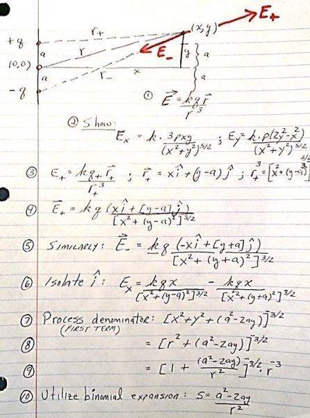

However, your handwriting and images are fairly clear, and you have taken the trouble to number all of your equations, which helps enormously, so I will answer.
It asks for two specific cases, a point on the x-axis and a point on the y axis. You do not need to work with P in general position.
In your equations (3) and (5), compare the signs on the ##\hat j## terms.

Thank you. I appreciate your feedback. It, does, though, not help at all. What I provided is many steps beyond the scope of your suggestion, and focuses on how to handle the binomial version of the denominator, and how to process it. Again, thanks anyway.

Then you have not paid proper attention to my final comment:

I did; I suspect you didn't read my post in its entirety - or you simply are stumped. I'd follow up with clarifying comments - but there's a ton in my post already.

Which post? Your original images or something since? I still don't see anywhere that you admit to having a sign wrong in equation 5.
That was a typo: but it's the x-hat term in Eq. 5 (I prematurely assigned a "-" sign to reflect the -x direction of E-; but didn't carry it through).
I disagree; the j-hat terms are indeed correct as written (this has been widely confirmed, and is a moot point).

Humour me: plug x=0 into equations 3 and 5, and consider y>>a. What do you notice?
