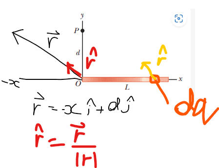

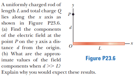

For this problem,
However, I am trying to solve this problem using an alternative method compared with the solutions. My method is:
##\vec E = k_e \int \frac {dq} {r^2} \, dx ## ##\hat r##
##\vec E = k_e \int \frac {\lambda} {x^2 + d^2} \, dx## ## \hat r##
If I let ## \hat r = \frac {-x\hat i + d\hat j} {\sqrt {x^2 + d^2}}## then I get the same answer as the solutions.
However, how dose ## \hat r = \frac {-x\hat i + d\hat j} {\sqrt {x^2 + d^2}}##?
I see intuitively that the ##\hat r## dose point in the same direction as the ##d\vec E## for each charge segment ##dq##.
Many thanks!
Of course. What is the vector from (x,0) to (0,d)?
What is its magnitude?
So what is the unit vector pointing from (x,0) to (0,d)?

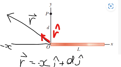

Thank you for your reply @haruspex ! Yes, thanks for pointing that out: I did mean ##\vec E = k_e \int \frac {dq} {r^2} \hat r##.
The vector pointing from (x,0) to (0,d) is ##\vec r = -x\hat i + d\hat j ## and its magnitude is ##\sqrt{x^2 + d^2}## so I guess we must divide the ##\vec r## but it's magnitude to find its direction to get ## \hat r = \frac {-x\hat i + d\hat j} {\sqrt {x^2 + d^2}}##
Then we just translate the unit vector ##\hat r## to the right for a charge element ##dq## as shown below:
Is my reasoning correct please?

Yes.

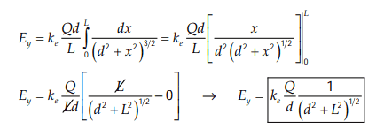

All the solutions say for the integration of the y-component of the electric field is:
Thank you!

You can check that easily enough by differentiating the result.
For trig substitution, what two trig functions do you know that satisfy ##g^2=f^2+1##?

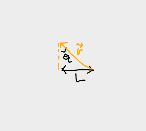

Thank you for you reply @SammyS !
## E_y = k_ed^{-1}\lambda\int_0^{\theta_L} cos\theta \, d\theta##
## E_y = k_ed^{-1}\lambda sin\theta_L ##
Where ##\theta_L## is the angle the position vector makes with in the ##-\hat j## direction to the end of the rod.
## E_y = k_e\lambda \frac {L} {d(L^2 + d^2)^{1/2}} ##
## E_y = \frac {k_eQ} {d(L^2 + d^2)^{1/2}} ##
Which is the same answer as the solutions! :)
