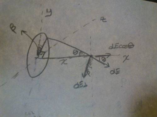

Suppose the charge Q on the ring of Fig. 28 was all distributed uniformly on only the upper half of the ring, and no charge was on the lower half. Determine the electric field \vec {E} at P.
[/B]
E = k\frac {q} {r^2}
[/B]
Starting with the charge density,
\lambda = \frac{Q}{\pi a} = \frac{dq}{dl}
electric field for dq
dE = k\frac{dq}{x^2+a^2}
Let's find its x component
dE_x = dEcos\theta = k\frac{dq}{x^2+a^2}cos\theta = kx\frac{dq}{(x^2+a^2)^{3/2}}
dE_x = \frac{k\lambda x}{(x^2+a^2)^{3/2}}dl
Wıth the limits being 0 and \pi a
E_x = \frac{k\lambda x \pi a}{(x^2+a^2)^{3/2}} = \frac{kqx}{(x^2+a^2)^{3/2}}
This is correct according to my textbook.
However, I end up with a wrong y component when I apply the same logic for the vertical.
E_y = -\frac{k\lambda a \pi a}{(x^2+a^2)^{3/2}} = -\frac{kqa}{(x^2+a^2)^{3/2}}
But the correct answer for the vertical is
E_y = -\frac{kq2a/\pi}{(x^2+a^2)^{3/2}}
Having searched the internet for this question, I found that the solution for the y-axis includes an arc length element, which is something like this.
\lambda = \frac {dq} {a d\theta}
Then I suppose, it integrates from 0 to \pi for a semi circle.
So my question is, how does that differ if one uses d\theta or dl for integration? Also, why did I get the x component correct, even though the fact that I used dl?

As you say, I'm probably missing something geometrical, but I can't see how dE*sin(theta) is not parallel to the y-axis in this particular situation. If its cosine component is parallel to the x axis, shouldn't its sine component be parallel to the y axis?

Pick an element of charge and imagine a line drawn from the origin to the element. This line will make some angle φ to the y axis. Imagine a plane that contains this line and the x axis. Can you see that the electric field produced by the element of charge will lie in this plane? So, the component of the electric field that is perpendicular to the x-axis will also lie in this plane. See if that helps in finding the y component of the field.
If my setup looks correct, then I would like to ask how to find a relationship between beta and theta.
You won't need a relationship between those two angles. Notice that θ is a fixed angle while β varies to cover all the charge elements. Your diagram looks good. How would you project ##dE_\perp## onto the the vertical dotted line?
Multiplying it with cos \beta?
If I am right, then I need limits for the integral. Would it be 2*[from pi/2 to zero], or 2*[zero to pi/2]?
I would use twice the integral from 0 to pi/2.
Thank you so much, I've managed to get the correct answer.
Just one more thing. Should the final result's sign always obey the direction of the vector?
Yes. If you are asked for Ey, then the answer should be negative. If you are asked for the magnitude of the y component, then that generally means just the absolute value.
