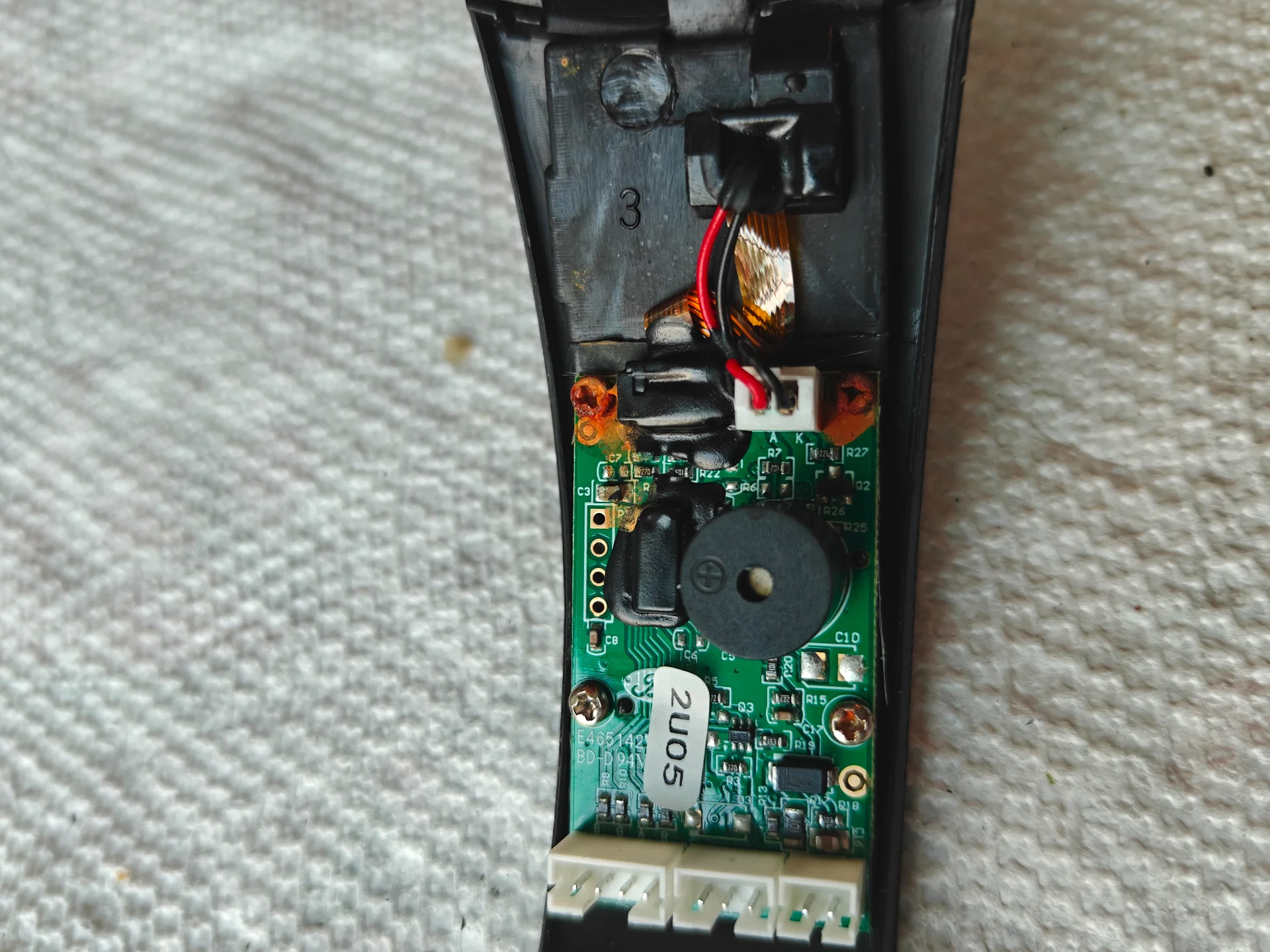

greetings
I've got a Chefman branded electric kettle (Chefman-Rj11-17) that went haywire -
the kettle can be turned on normally, and the small LED on the handle displays water temperature, however, during the heating process, the temp displayed jumps to 212F rapidly, and the kettle turned off automatically while the water is still lurk warm.
I took apart the kettle and it seems that there's a little nipple at the bottom of kettle to be a temp sensor and hooked up with circuitry in the handle, but i'm not sure which part gone bad
https://www.manualslib.com/manual/2729451/Chefman-Rj11-17-Tcti.html?page=9#manual
any advice?

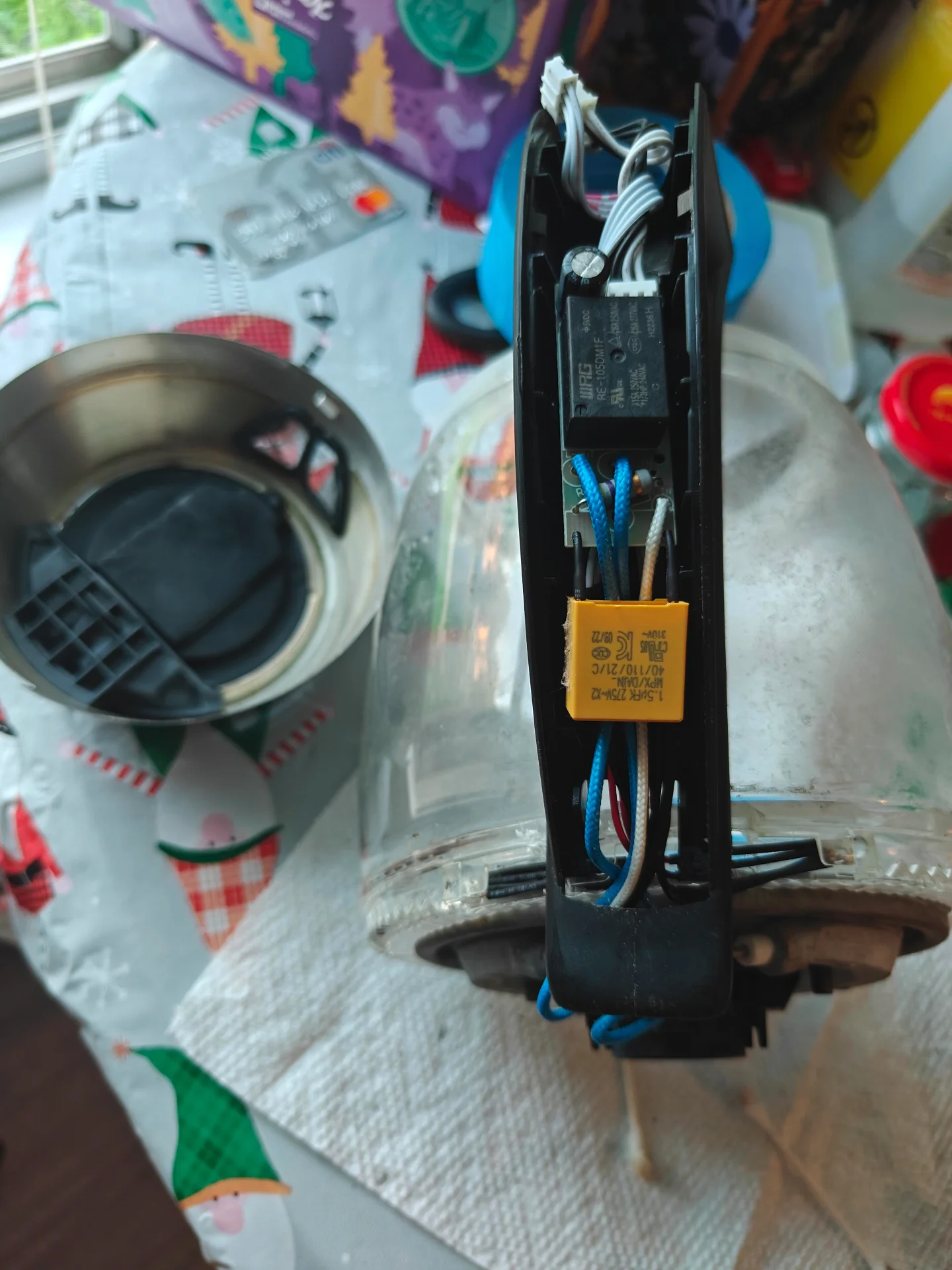

  • Photo of an electric kettle's handle opened up, showing a black housing with a relay, a yellow capacitor labelled 1.5µF 275V~, and blue and white wires; the kettle base sits beside it.
  • Interior of a kettle handle showing a green circuit board with a black buzzer, a red and black wire lead, a white connector and surface-mount components labelled R7, R22, Q2 and C10.

There is corrosion of the circuit board, second picture, near the screws and components.
Try to clean that carefully, and hopefully that ( surface corrosion ) was the cause of the problem.
