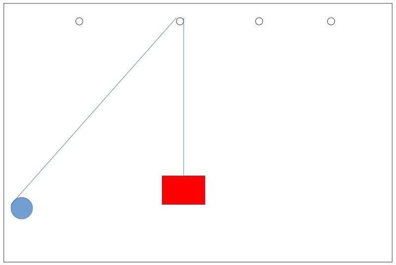

What kind of electric motor / controller provide a wide range of torque at the cost of speed without destroying the motor?
I'm bothered by a winch being very slow at light loads and was wondering if a different motor / motor controller / gear could increase the low load speed without sacrificing the high torque at low speed? And also without destroying the motor?
Is there a chance that the right combination of motor, controller and (worm) gear, the output could be controlled in the range 800Nm@5rpm to 10Nm@400rpm? (If my calculations are correct, both of this scenarios should require the same power.)
What kind of motor / controller is more suitable for such application?
Available power is DC 24V, max 20A.
The usage of worm gear is to prevent the wire from being unrolled when no power is applied, even under load.
I'm hoping for a controller that automatically increases torque when higher load is detected, but does not go above the max power allowed, which I expect to result in reduced speed. I'd also appreciate the ability to set max torque and max speed at the controller for scenarios where those should be limited.

We haven't been given anything for load specs, specific speeds of the wire rope, what an existing winch looks like, etc. until we see that, everything suggested is simply an avenue towards a possible solution that the OP will have to figure out.
Specs for speed and load is given in initial post: 800Nm@5rpm to 10Nm@400rpm
That is on the output shaft after gear. I think the gear has to be of worm type because of hanging load. Other gears in addition to the worm gear is a possibility.
The only number that is a requirement is the 800Nm. The 5rpm is about the speed I'd guess a 500w motor to be able to hold at that torque with ~85% efficiency. With such high load I have time to wait for it to do it's work. It's not often I'll need it to run at max load. And that is the argument against the electric winches I find in the stores - they run at the slow speed of max load even with zero load - they run at constant speed rather than constant power. When I give it a quarter load (which probably will be the most used condition), I'd like it to run at ~4x speed. I don't want it to run at that slowest speed all the time just because I need it to be able to do that heavy lift once in a while.
The 400rpm is to indicate that the speed at low load should be much faster than with high load. If it's 200 or 600 rpm doesn't really matter, and the 10Nm is what I'd guess a 500w motor could be able to pull at 400rpm.
Winch will be used many times a day, every day for some weeks when I'm doing some project with heavy lifting. Then it may be several months without any use at all.

You are trying to get from where you are now to somewhere different. But we do not know where you are now, because we have not seen the layout of your existing system. That is why we think in generalities, and why we suggest replacing the entire system.
solvejskovlund said:
Hydraulic sounds too complicated.
Yet it is probably the simplest solution, with the highest speed ratio. It is bidirectional, with neutral, and has the greatest power to weight ratio.
We do not know what you are trying to do, because we are not mind readers, while you are trapped into using what you know, which has not worked to date.
Why do you use a wire on a winch drum, when you could use a simple loop of chain?
Here is a sketch of the shed. There are several locations for lifting points. Winch will be used for lifting as well as horizontal pull (which actually is a slope)
The speed-torque curve you are after could be satisfied with a compound-wound motor.
