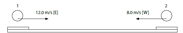

Two frictionless pucks are placed on a level surface, as shown, at an initial distance of 20 m. The mass of puck 1 is 0.80 kg and it has a charge of +3.0 x 10^-4 C, while puck 2 is 0.40 kg with a charge of +3.0 x 10^-4 C. The initial velocity of puck 1 is 12 m/s [E] and the initial velocity of puck 2 is 8 m/s [W]. Find the minimum separation of the two pucks (the minimum distance between the pucks).
Attempt at the solution:
Let right be positive
Kq1q2/r = 0.5 -m1v1^2 + m2v2^2
9 x 10^9 Nm^2/C^2(3 x 10 ^-4 C) ( 3 x 10^-4 C) /r = 0.5(-0.80)(-12)^2 + (0.40)(8)^2
810Nm^2 / r = 70.4 kgm^2/s^2
r = 11.51m
20 - 11.51 = 8.50m
Is this right?

They have PE in both states: initial and final.
And the way you write it, seems that you have 1/2 only for one of the kinetic energies.
.5 (0.80) (12)^2 = 57.6, .5(0.40)(8)^2 = 12.8
57.6 + 12.8 = 70.4 same results
I don't know what these numbers mean.
But the conservation of energy is missing the initial PE.
Write the equations first and then start with the numbers.
How can be 70 m when they approach each other from 20 m?

Their speeds would be maximum but, throughout the process, the total Momentum would be the same as at the start. When they are very close, the value of the Potential will be governed by their actual radii, so the question is not fully specified.

Their relative velocity would, of course, be zero at their nearest approach so, why not work in the frame of the CM and give them velocities of half the difference? Then you only need to work with one ball and use KE = PE to give the distance from each stationary ball to their CM. Doing it that way will reduce the possibility of mechanical errors.
