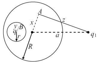

A cavity is made inside a solid conducting sphere and a charge q is placed inside the cavity at the centre. A charge q1 is placed outside the sphere as shown in the figure. Point A is inside the sphere and point B is inside the cavity. Find potential at A and B.
[URL]http://203.196.176.41/VLEBT_RootRepository/Resources/5cef7d9a-41c3-4283-bf26-9a89c8369923.jpg[/URL]
The problem I have here is the effect of outer charge on the potential. There will be an induced charge -q1 on the sphere due to it. So the potential due to -q1 is -kq1/R.
There will be induced charge of q on the outer surface of the bigger sphere, so potential due to it at A=kq/R
VA= -kq1/R + kq/R
Is it fine? How do I calculate V at B? I am a bit confused here.

What is the charge induced by q1 on the surface? Isn't it equal to -q1?
Can you explain an easy method to find out the potential at B?

What is the location of q1 relative to the sphere?

It is at a distance 'a' from the centre of the sphere.
This requires using the principle of superposition to "build up" a solution.
Place the sphere, radius R, so its center is at the origin. Place charge q1 on the x-axis at x=a, a>R. Now let's see if we can replace the sphere with a charge of q2 located at x = p on the positive x-axis at the proper location, and with the proper charge to make the potential zero at r = R, i.e. at x2 + y2 + z2 = R2, the place where the surface of the sphere was located.
We'll just work at x = ±R. That will give two equations in two unknowns.
At x = R we have  [tex]V=\frac{kq_1}{a-R}+\frac{kq_2}{R-p}=0\,.\quad\to\quad\frac{q_1}{a(1-\frac{R}{a})}+\frac{q_2}{R(1-\frac{p}{R})}=0[/tex]
At x = ‒R we have  [tex]V=\frac{kq_1}{a+R}+\frac{kq_2}{R+p}=0\,.\quad\to\quad\frac{q_1}{a(1+\frac{R}{a})}+\frac{q_2}{R(1+\frac{p}{R})}=0[/tex]
By inspection, both equations will work if:
[tex]\frac{q_1}{a}=\frac{q_2}{R}\quad\text{And}\quad\frac{R}{a}=\frac{p}{R}[/tex]
For fun, verify that this makes the potential zero whenever x2 + y2 = R2.

I got q2= -q1R/a
I calculated the potential due to q1 and q2 and found them to be equal to -kq1/R + kq1/a (assuming that the point B inside the cavity is inside the sphere formed with radius 'p').
Thank you for teaching me about image charges :smile:

The image reappeared in my laptop today.
I am attaching it.
To find the potential of the the sphere having a charge of q on its surface, use the DIFFERENCE: q - q2 = q + q1R/a on a sphere of radius R.
I did not get your point here.
In the figure,
V at B = kq/R - (kq/y - kq/r) -kq1/R + kq1/a
Is this not right?

Not right.
The conducting sphere is all at one potential, because the E field is zero everywhere within the conducting material.
The potential at point B minus the potential of the sphere is: VB ‒ Vsphere = kq/y ‒ kq/r .
All that's needed beyond this is to find the potential of the sphere.

Let's build up a solution using superposition:
A charge of -q1R/a at x = p, where p = R2/a and a charge of q1 at x=a, will produce a potential of zero a distance of R from the origin -- that is the location of the surface of a sphere of radius R centered at the origin.
We could replace a grounded sphere (radius R, center @ origin) with this image charge. The electric potential and the E field would match everywhere beyond a distance of R from the origin, for either configuration.​
... but we don't have a grounded sphere.
That brings us to the next step:
Start with a neutral conducting sphere (radius R, center @ origin), bring a charge of q1 from ∞ to x = a. This sphere is NOT grounded ! We could replace the sphere with our image charge, q2 = ‒q1R/a at x = R2/a , plus a charge of ‒q2 = +q1R/a @ the origin, in addition to the charge q1 @ x = a. But think about it! ... q2 @ x = p and q1 @ x = a give us a potential of zero @ a distance of R from the origin, ...
so, simply use a charge of q1R/a at the origin --- to find what the potential of a neutral conducting sphere of radius R, center @ origin.
However, our sphere has a net charge of q on it's exterior, so to find the potential at it's surface, find the potential @ a distance of R from the origin, due to a charge of q + ‒q2 = q + q1R/a all situated at the origin.
This gives the potential of all of the conducting sphere including all the way down to the surface of the cavity in it.

(The following is prior to taking into account the presence of charge q in the cavity.)
IF the sphere were at zero potential (grounded), then bringing charge q1 into place would induce a charge of q2 = -q1R/a on the sphere.
BUT, the sphere is neutral & it's not grounded. In this case, charge q1 changes the distribution of charge on the surface of the sphere, but it can't add or remove charge. We can model this as the superposition of two spheres (at the same location). One has charge q2 distributed in such a way that it produces an E field identical to what the equivalent image charge would produce. The 2nd sphere to be superimposed must have a charge equal in magnitude & opposite in sign to q2, so this second charge is -q2. It is uniformly distributed over the surface of the conducting sphere. Keep in mind that -q2 = +q1R/a .
Since the image charge merely gives zero potential at the surface of the sphere, all you need is the charge -q2 = q1R/a. NOW add to this the charge of q, also distributed uniformly over the surface of the sphere. These will give you the potential of the sphere.

Let me write the final analysis-
If we remove the cavity and consider a full sphere (w/o cavity) of radius R with charge q+q1R/a on it, the potential at point B is kq/R + kq1/a
Now since there is a cavity with charge q at the centre and -q on its inner surface, potential at B = kq/y - kq/r
So net potential al B = (kq/R + kq1/a) + (kq/y - kq/r) (by using superposition principle)

So net potential al B = (kq/R + kq1/a) + (kq/y - kq/r) (by using superposition principle) YES!
Sorry, I missed the question.
Yes! I think you've got it!
