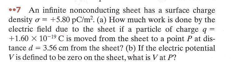

See figure below,
Textbook problem 7 text: infinite nonconducting sheet with surface charge density sigma = +5.80 pC/m^2; asks work by the field to move charge q = +1.60 x 10^-19 C from the sheet to point P at distance d = 3.56 cm, and the potential V at P if V is zero on the sheet.
I'm not sure how to use the sigma factor in this question.
I know that,
[tex]W= Fd[/tex]
So,
[tex]W = Eqd[/tex]
but I don't know how to get any farther.
What am I missing? How do I take advantage of sigma to get what I want?
  • Textbook problem: infinite nonconducting sheet with surface charge density sigma = +5.80 pC/m^2; asks work by the field moving charge q = +1.60 x 10^-19 C to distance d = 3.56 cm, and potential V at P with V = 0 on the sheet.
Do you know the electric field due to infinite large sheet?
