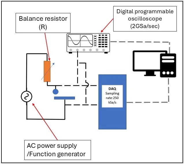

I am a mechanical engineer researching electrical damage in lubricated contacts. In my tests, I apply 18V DC across a steel ball-disc contact with an elastohydrodynamic lubrication film (more simply an oil film between 600-900 nanometers in thickness) between the surfaces. This film, according to recent research, acts as a capacitor and a resistor in parallel. I observe dielectric breakdown of the film (as expected, as the applied voltage exceeds the electric field strength of the film), and the voltage signal across the contact shows the breakdown as a voltage drop.

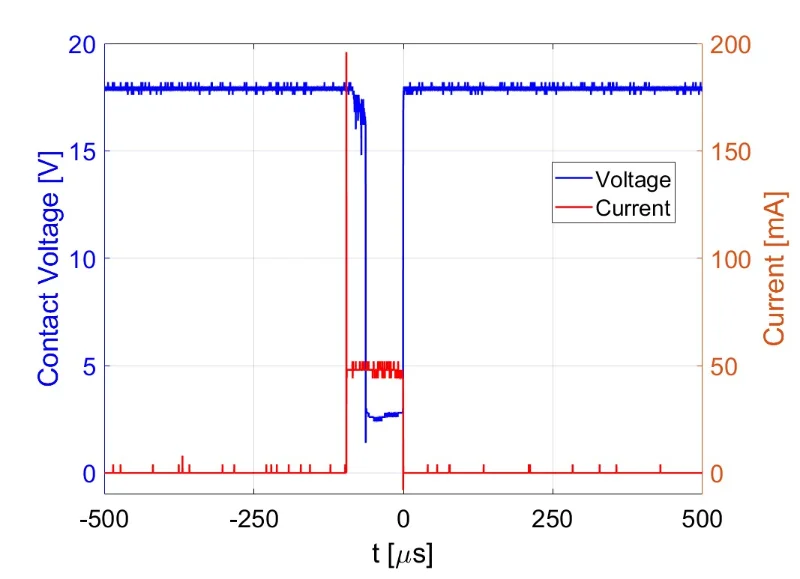

The voltage drops from 18V to 2V and has a duration between 80-100 microseconds. The current during the breakdown is limited to a maximum of 50 milliamperes using a variable resistor in series to the ball-disc contact. A sample signal of voltage and current captured during the test is attached, showing the nature of the breakdown. I also observe craters on the steel surfaces resembling the electric discharge damage.
Does the signal show an electric discharge or an arc? Because discharges are instantaneous and the signals show a standing wave in some cases, having a 100-microsecond duration. Also, if I want instantaneous discharge of energy and prevent arcing, is adding a capacitor in series the right way to move forward?

The positive current spike at the instant of contact is the discharge of the electrode and cable capacitance. I see no oscillation that would be present if an arc was being maintained. I would expect an inductive voltage spike as the current stopped flowing.

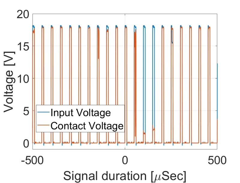

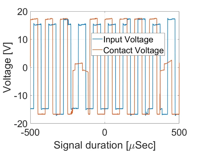

6. I can attach a schematic of the setup and some voltage signals captured during the DC voltage test, square wave AC voltage test at 10 kHz and DC pulse voltage DC (which is similar to EDM voltage).
I hope that helps.

As I see it, you are experimenting with EDM die sinking, but you do not want it to actually remove metal, or for the die to sink.
There are two parts to each conduction event. Make, then break.
The first is the "make", or contact closure. At that moment, the gap capacitance is immediately discharged through the oil, without any possible external regulation of that high current discharge.
That capacitor energy, E = ½⋅C⋅V2; will heat and denature a small volume of oil, which may raise the temperature of the oil sufficiently, to erode the contacts. The capacitance is specified by the contact dimensions, so the only way to reduce erosion is to reduce the voltage. Lower voltage will break a thinner film of oil, so the capacitance will be proportionally greater, but the available energy will be reduced by the square. Going from 18 volts to 1 volt reduces energy by a factor of 182 = 324, but the thinner film capacitance rises by a factor of 18, so the energy reduction overall, is only by a factor of 18. I do not know how important it is for you to operate the rig at 18 volts, or with a 19 mm ball.
The second event is the "break", when the contacts open. The difference between your rig, and EDM is that, for EDM, series inductance would be used to maintain and repeat the arc, maximising arc energy, and so erosion. If you minimise inductance, say by using a snubber, or a terminated transmission line, then there is no reason to expect significant erosion during the single break event. It is the multiple re-strikes that causes the damage.

Why, during conduction, does the contact voltage only fall to 2 volts ?
I would expect a metallic contact voltage to be closer to ten millivolts.
It could be because there are 40 ohms of series resistance in the return circuit to the ball and disc. With up to 50 mA flowing in that circuit during conduction, there could be 2 volts added to the gap voltage.
The prototype model now shows that you have something like an uncontrollable 10 amp current pulse flowing when contacts first breakdown. That current rapidly falls off, and is regulated to 50 mA. I guess those 10 amps are blasting the craters.
I see no significant arcing when the contacts open. That is quite unlike EDM, where the circuit design would deliberately encourage contact arcing, by the inclusion of inductance.
I would suggest the 2 volts is related to the work function of the material. I should have thought that oscillation in the GHz region would occur, corresponding to the dimensions of the sphere and any associated conductors. An electric spark can have a rise time of picoseconds.

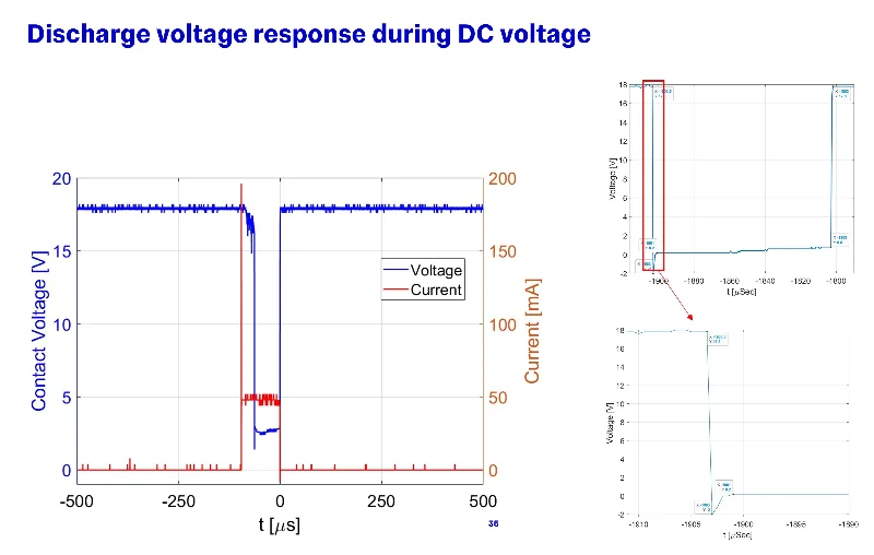

That is not always. Some signals show voltage dropping to almost 0V as well. Also, I have repeated my DC voltage test on another rig that has a much better electrical setup done by the company that manufactures these rigs. I have attached the signals from both for comparison. The repeat test does show a cleaner signal, but the behaviour is consistent.
As for the 10-amp current pulses, I don't think that is the case. As I mentioned before, when I reduce the maximum current from 50 mA to 10 mA, I don't observe the damage. If there is a source of 10 amps and if it is there during the 10 mA test, the damage should still occur. Moreover, 10 amps is very high, and the discharge crater I have observed has a 0.7-1 micron diameter with a maximum depth of 80 nm. This shows good agreement with the damage observed in field bearings where stray current flows in the milliampere range.

When several hundred pF of contact capacitance, is charged to 18 volts, the current during the initial voltage breakdown of the oil, will be limited by the contact resistance. What is the resistance of the contact, and how does that change with time?
Current alone does not cause the damage. There needs also to be a voltage across the gap, or energy would not be dissipated. W = V * I .
