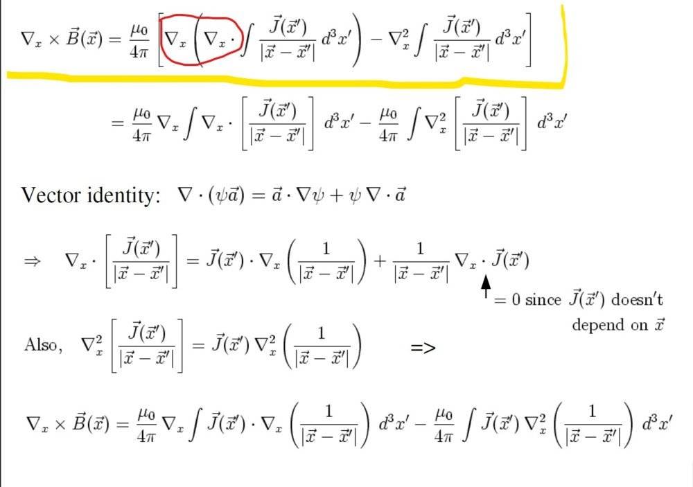

Please see attached screenshot. Why are the red circled Del operators not combining to give a net result of 0?
Vector Calculus
Why are the red circled Del operators not combining to become 'Del-squared' to cancel out the second term to give a net result of 0?
Because $$\nabla(\nabla. ) \neq (\nabla.\nabla = \nabla^2) $$
Alternatively,the red circled termed is vector whereas ##\nabla^2 ## is scalar called Laplacian.
This thing you can find in almost all Basic Vector Calculus books.

Could you please cite a page number or section from an online page where that distinction is fully explained? I thought I understood it what you meant but I am still getting tripped up.
There is a basic difference between the two, one operates on a vector and the result is a vector,
$$\vec \nabla(\vec \nabla \cdot \vec A)=\left(\frac {\partial}{\partial x} ~\hat x+\frac {\partial}{\partial y} ~\hat y+\frac {\partial}{\partial z} ~\hat z \right )\left(\frac {\partial A_x}{\partial x} +\frac {\partial A_y}{\partial y}+\frac {\partial A_z}{\partial z} \right ).$$The other operates on a scalar and the result is a scalar,
$$\vec \nabla \cdot \vec \nabla \varphi =\left(\frac {\partial ^2}{\partial x^2} +\frac {\partial ^2}{\partial y^2}+\frac {\partial ^2}{\partial z^2} \right )\varphi.$$

To add to this. In the attached example, ##\nabla^2## is actually acting on a vector. In this case, by definition:
$$\nabla^2 \varphi = \vec \nabla \cdot \vec \nabla \varphi =\left(\frac {\partial ^2}{\partial x^2} +\frac {\partial ^2}{\partial y^2}+\frac {\partial ^2}{\partial z^2} \right )\varphi.$$
And, also by definition:
$$\nabla^2 \vec{A} = (\nabla^2 A_x) \hat{x} + (\nabla^2 A_y) \hat{y} + (\nabla^2 A_z) \hat{z}\ne \vec \nabla(\vec \nabla \cdot \vec A)$$

And the distinction between the two is illustrated by the vector calculus identity
$$\vec \nabla \times (\vec \nabla \times \vec A)=\vec \nabla(\vec \nabla \cdot \vec A)-\nabla^2 \vec A.$$
