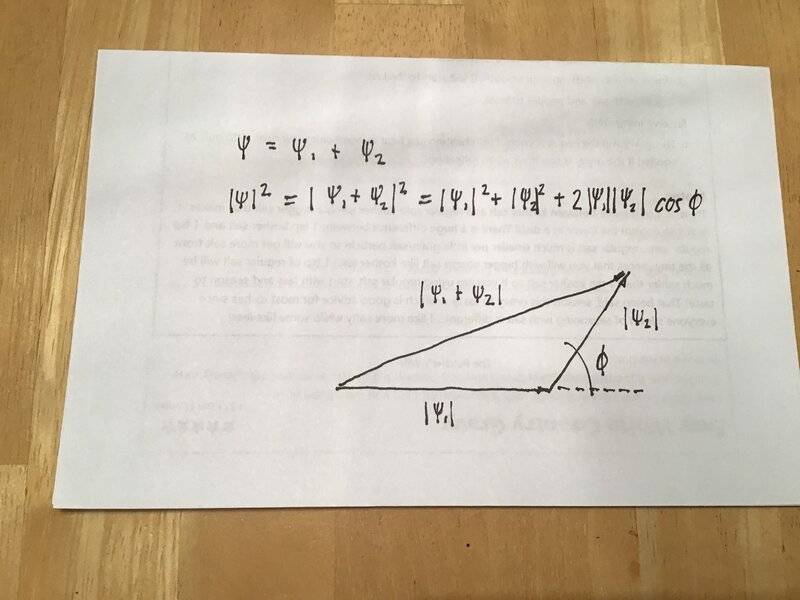

To find the probability of detecting an electron at the screen in a double slit experiment, my textbook uses a phasor diagram as shown. Although I am familiar with the addition of waves similar to vector addition I cannot follow this step and will appreciate an explanation
The diagram rotates around the left hand point of the triangle at the frequency. Components 1 and 2 then add to give the value represented by the hypotenuse. The angle phi is the phase difference between the two waves at a given point on the screen.

It's not your fault that you don't understand this calculation, because it does not make any sense. Which textbook are you using? In a complex vector space, as is the separable Hilbert space used in QM, there is no notion of "angle" between vectors.

I see. So it's simply phase factors, ##\exp(\mathrm{i} \varphi)##. So what's discussed here is
$$\psi=\psi_1 + \psi_2=R_1 \exp(\mathrm{i} \varphi_1) + R_2 \exp(\mathrm{i} \varphi_2),$$
with ##R_1,R_2>0##. Then of course, with ##\phi=\varphi_2-\varphi_1|##:
$$|\psi|^2=\psi^* \psi = |R_1+R_2 \exp(\mathrm{i} \phi)|^2=[R_1+R_2 \exp(\mathrm{i} \phi)][R_1+R_2 \exp(-\mathrm{i} \phi)]=R_1^2 + R_2^2 +R_1 R_2 [\exp(\mathrm{i} \phi) + \exp(-\mathrm{i} \phi)]=R_1^2+R_2^2 + 2 R_1 R_2 \cos \phi.$$
Since ##R_1=|\psi_1|## and ##R_2=|\psi_2|## that's indeed the equation given in the OP.
The important point is that only relative phases in superposition play a role. Wave functions, which differ only in a phase factor (or "a phasor") represent the same pure quantum state of the electron, i.e., it's not the normalized vectors but the (unit) rays that represent pure states in quantum mechanics.

I don't understand the problem. I've given the derivation in detail. I never understood the hype about drawing such "phasor diagrams". We had them in high-school, and I had an agreement with my physics teacher that I could use complex numbers instead, because I was never good in drawing such diagrams ;-).
