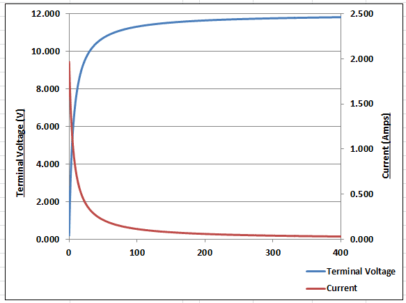

Thanks for that everyone.
A 12V battery has an internal resistance of 6Ω.
a) If this battery is connected to a 10Ω load, calculate the power dissipated by the load.
b) Draw a graph showing how the terminal voltage of the battery and the current it can supply vary with load.
c) Derive a value for the maximum power this battery can deliver. What load resistance should be applied to the battery for this to occur?
I did question A) again and got 5.625W by doing the following:
I=V/(R+r) = 0.75A
P=I2R, 0.752x10 = 5.625W
For part B I plotted a graph by using calculated values from a table within excel. Initially I didn't expect the graph to be exponential as shown.
As for part C from my table I get 6W at a load of 6Ω for the maximum power output of the battery.
Does this seem right?
Thanks
I=V/(R+r) = 0.75A
Thanks
Yes, looks right. :smile:
You've also got the right answer for part A this time.
The graph is not exponential, BTW, it's a hyperbola.
So what can you say about the load where maximum power delivery occurs?
That is reassuring!
Looking at the graph without sensibile consideration the obvious answer is that the load must equal the terminal voltage to maximize power transmission. (Which I know is wrong)
For Pmax: RLoad = VT
The other obvious answer is that the Internal resistance of the battery must equal the Load resistance which can be seen in this case:
Rinternal = RLoad (which is the correct answer)
Which follows the Maximum Power Transfer Theorem. Therefor maximum power transmission will occur at this point but not maximum efficiency.
That makes sense now right?
