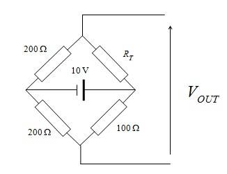

The bridge circuit below is used to monitor temperature using a thermometer. The thermometer RT has resistance of 100 Ω at 0°C and a linear coefficient with temperature of 0.005 Ω/°C. What is the sensitivity of the bridge (ΔVOUT/ΔT) around 100 °C for ΔT = 1°C? How does it compare with sensitivity around – 100 °C?
Wheatstone bridge circuit diagram with resistors 200 Ω (upper left), RT (upper right), 200 Ω (lower left) and 100 Ω (lower right), a 10 V battery across the middle, and output voltage VOUT measured between top and bottom.
(ΔVOUT/ΔT) = Sensitivity
RT=(1+aΔT)
I attempted to calculate output voltage,
First I calculated RT=100* (1 + 0.005 * 100) = 150Ω which is the resistor of the transducer
Then I calculated v1 and v2
v1 = 10*(200/200+200) = 5V
v2 = 10*(150/200+150) = 4.29V
hence Δv=0.71V
and sensitivity = 0.71/1 = 0.71I'm not sure what I've done makes any sense, I followed an example for a wheatsone bridge, any help will be appreciated greatly, thanks =D.
Hi brokenbarbie, Welcome to Physics Forums.
You have the right idea about determining Vout by first finding your v1 and v2. But things go off the rails from there :smile:
The first step should be to find an expression for Vout rather than a particular value at a particular temperature. Just leave RT as a symbol and find the expression for Vout. You can plug in an expression for RT later.
Then you want to head towards finding ##\frac{d}{dT}V_{out}##, either by way of calculus, or I suppose you could "brute force" it by plugging in temperatures +/- the ΔT and determining the corresponding ΔVout.

No, that would be against forum rules; We can't jut do your homework for you. We can provide hints, corrections, and so forth, but you must show some effort and do the bulk of the work.
Cheers.
