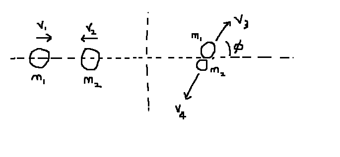

I've done a sketch that shows something like:
I know that in the zero-momentum-frame the total momentum must be zero, so their momentum are aligned. (different masses results in them having different velocities, in order to ensure Ʃp = 0)

Just for the math folk, let's use ##\varphi## rather than the empty set for our variable. :-p
You have the velocities of the two masses. Velocity is a vector. The question you need to ask yourself is "how do you find the angle between two vectors?"
You probably meant speed, in which case...how do you relate speed and velocity?

I know the answers to all your questions, but I'm not sure if they're helpful in this question...:confused:
