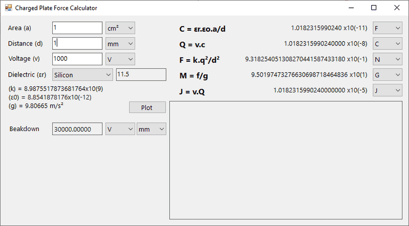

Hey everyone,
This is my first post here, please forgive me if it's in the wrong place.
Years ago I made this small app in C# for calculating the force, in Newtons, between two oppositely charged plates that can take various parameters. I've never truly believed the numbers it outputs as they just seem too high to me. I'm curious if anyone here knows a bit about electrostatics and the formulas I've used, and if you'd be kind enough to either verify the formulas or shed some light on where I might have gone wrong. Any thoughts are much appreciated.
Here's a screenshot of the app with some parameters filled in. I'm happy to send the application to anyone who wants to test it out.
Matt
You wrote the Coulomb force on one point charge due to another point charge.
That, however, is not the force experienced by one charged plate due to another.
What is meant by f/g? Are you trying to computing the mass of something?
By the way, are you familiar with significant digits?
You can use a tool like Desmos (https://www.desmos.com/calculator) to prototype and to check your work.
Ah I see. Do you know where I might find some helpful information on the equation I need?
Yeah I think my idea here was - if the two plates were horizontal and were attracted to each other, how heavy an object can the bottom plate hold up without it separating.
No, I've not heard of the term before... am I displaying the results incorrectly?
Cool, I'll use that! Many thanks!
